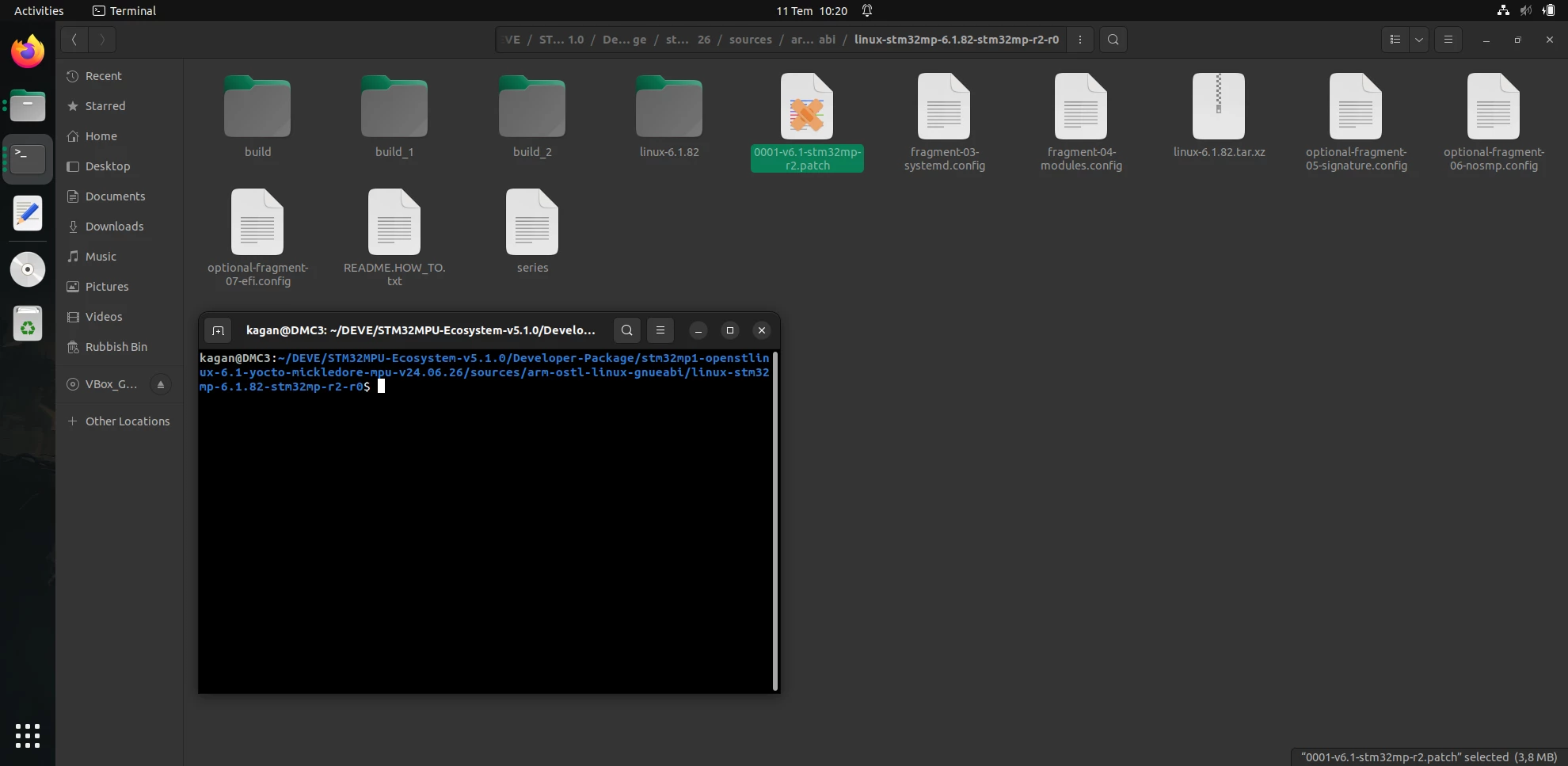

I'm trying modify device tree following this website :STM32MPU Developer Package - stm32mpu
than now Im working on :meta-st-stm32mp/recipes-kernel/linux/linux-stm32mp/README.HOW_TO.txt at mickledore · STMicroelectronics/meta-st-stm32mp · GitHub
My problem is in the kernel source directory  (STM32MPU-Ecosystem-v5.1.0/Developer-Package/stm32mp1-openstlinux-6.1-yocto-mickledore-mpu-v24.06.26/sources/arm-ostl-linux-gnueabi/linux-stm32mp-6.1.82-stm32mp-r2-r0$)
I have
 0001-v6.1-stm32mp-r2.patch             linux-6.1.82.tar.xz
build8                     optional-fragment-05-signature.config
 optional-fragment-06-nosmp.config             optional-fragment-07-efi.config
fragment-03-systemd.config                      README.HOW_TO.txt
fragment-04-modules.config                      series
But I dont have Makefile.sdk
I believe
 ##LINUX_TARNAME## =linux-6.1.82.tar.xz
00*.patch =0001-v6.1-stm32mp-r2.patch
But I there is no makefile.sdk can you help me

Hi @kagan_senkeser ,
There's no Makefile.sdk for kernel sources, just follow the commands suggested in the wiki or README_how_to.
Please note that the README you're sharing is for the kernel sources of the distribution packages, not the sources of the development packages.
However, the bug you pointed out has been reported and will be fixed.
Regards,
Grégory
