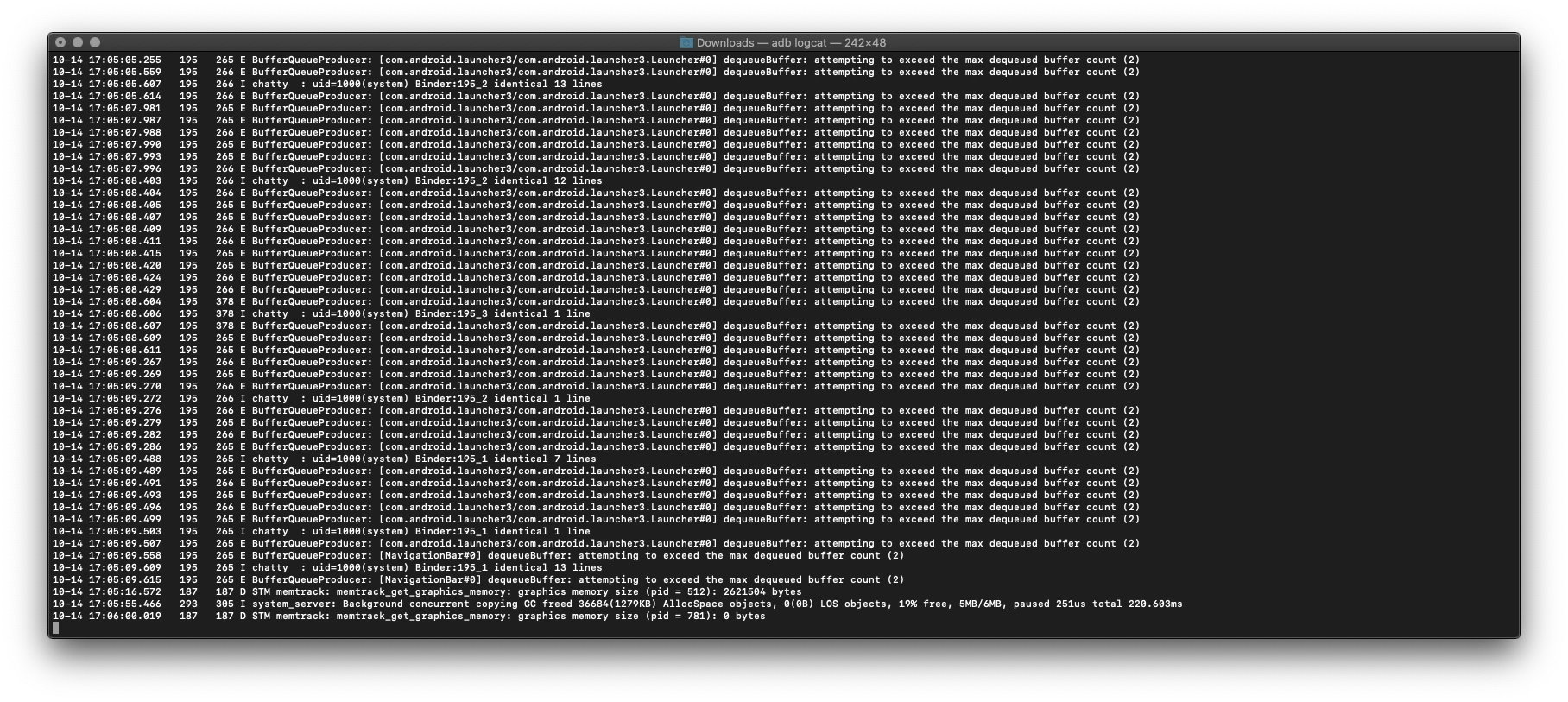

Poor performance of Android
The number of frames per second does not exceed 10. Will there be any performance improvements? Are there any tips?

Hi @Mikalaj Karhin​
The AOSP Android porting is delivered as example/enabler with the performances expected for the MP1 (DualCore A7, 1GBytes)
Then, you cannot expect same level of performance than with an OctoCore at 2Ghz + High end GPU.
I remind you the recommended configuration:
   Display @480p
    DDR32bit 1GBytes
 The STM32MP15X-EVAL includes by default a display @720p, which has impacts on performances.
The Andoid AOSP aim to make application in adequation with platform usage target (typically not smartphone UI like application)

Hi @Mikalaj Karhin​
Are you using STM32MP157-DK2 board ?
Android can not run smoothly on this development kit, you have to use STM32MP157-EV1
Not that a new version of st-android is available :
https://wiki.st.com/stm32mpu/index.php/STM32MP15_distribution_for_Android_release_note

Mikalaj Karhin
October 15, 2019
@Community member​
Yes, I use STM32MP157-EV1 with the latest version. Video.
