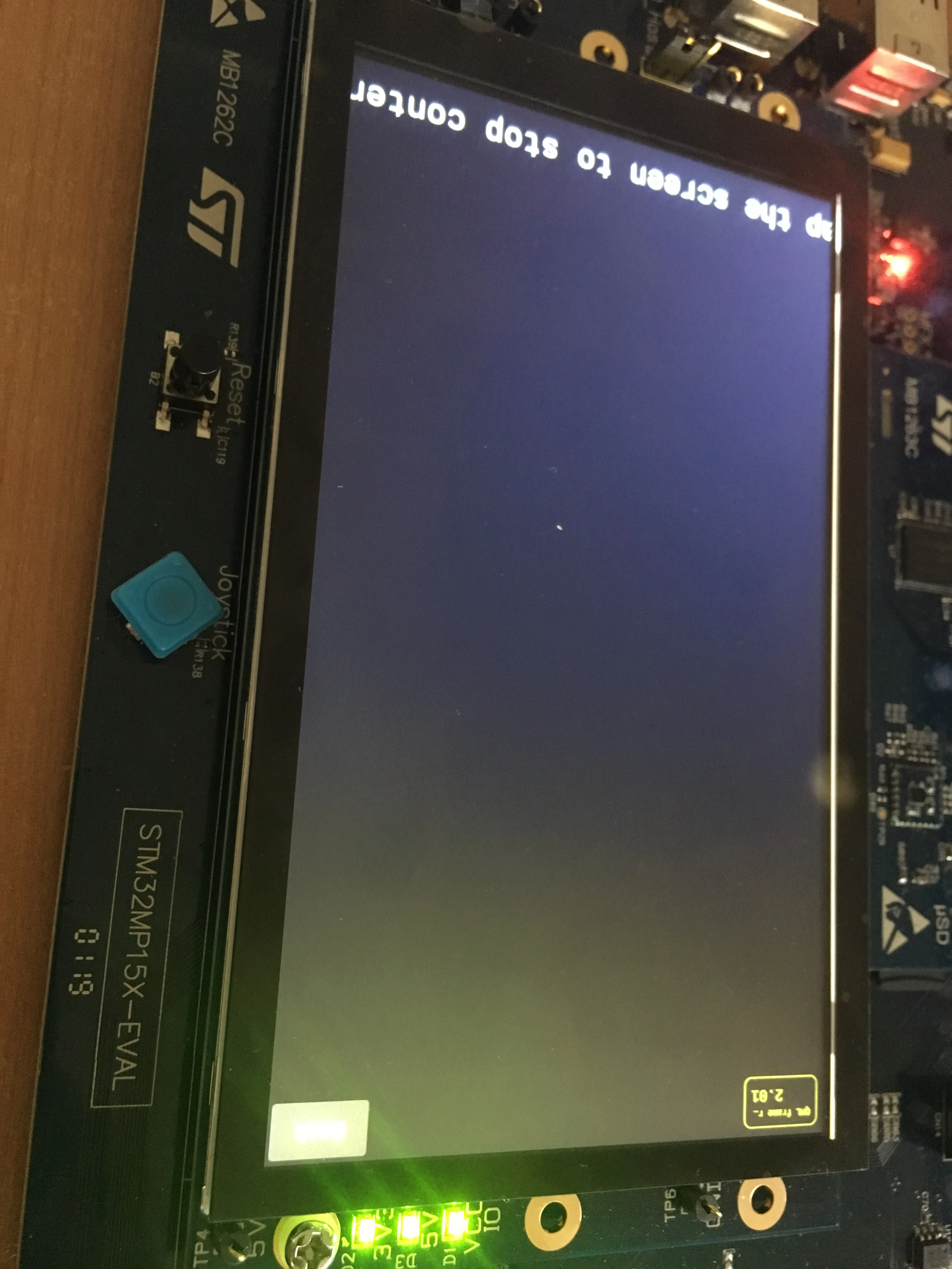

I want to play a video from mounted USB stick. Once USB plugged the host, I mount it with "mount /dev/sda1 /mnt" and than quit the psplash screen with "psplash-drm-quit" on target. After that, trying to play a video with "gst-launch-1.0 playbin uri=file:///media/aaa.mp4" but there is nothing screen on TFT. Also, I have tried this "gst-launch-1.0 v4l2src ! "video/x-raw, width=1280, Height=720, framerate=(fraction)15/1" ! queue ! autovideosink -e" command but there is nothing again.

gokhannsahin
July 31, 2019
This example can't play the video. A black screen always seems. I attached a screen of it.
Is it possible to use wayland with qt for your example distros?(if choose openstlinux-weston)
Or which is better performance while playing a video?
EDIT:
It was solved after installed qt to /opt/ path.
