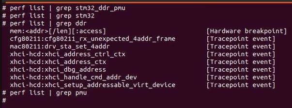

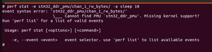

We are following the steps mentioned in this link How to measure the DDR throughput - stm32mpu.However we are facing the below error while trying to use stm32_ddr_pmu

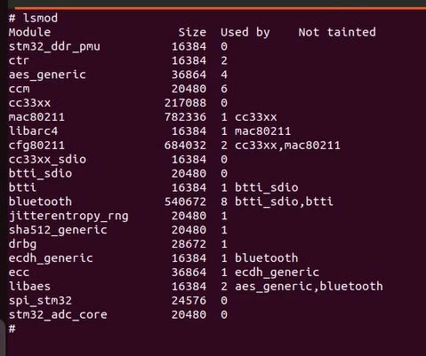

We inserted the lkm module stm32_ddr_pmu.ko using modprobe. The lsmod lists the stm32_ddr_pmu
The zcat shows that CONFIG_STM32_DDR_PMU is enabled
perf list does not show the stm32_ddr_pmu
