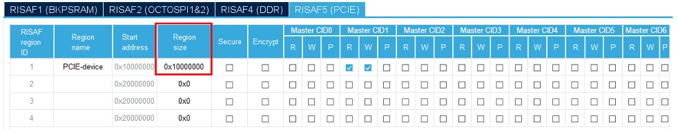

Hi everyone,
I'm currently working on the PCIe part of the STM32MP25 and would like to ask if there's anything wrong with my configuration. I’ve followed the official documentation provided by ST.

I’m getting the following error message:
# dmesg | grep -i pcie
[ 0.000000] Machine model: pcie-cid1-STMicroelectronics custom STM32CubeMX board - openstlinux-6.6-yocto-scarthgap-mpu-v24.11.06
[ 1.579191] stm32-pcie: probe of 48400000.pcie failed with error -110
[ 19.617558] psci-cpuidle-domain psci: sync_state() pending due to 48400000.pcie
Any suggestions or guidance would be greatly appreciated.

Jul 24, 2025 4:22 AM UTC
How did you resolve the problem? I'm having the same issue. Moreover, when I'm trying to kill PCIe in device tree entirely, my board would not stay in suspend mode, would wake up right away.
Jul 25, 2025 5:56 AM UTC
Hi RossU,
I'm not sure if you're encountering the same issue as I did, but I later discovered in CubeMX that the Region Size was not configured, as shown in the image below.
Additionally, you might find this article helpful — it discusses a similar issue and could be related to what you're experiencing:
Solved: Re: SSD insert PCIe and start System Report IAC e... - STMicroelectronics Community
