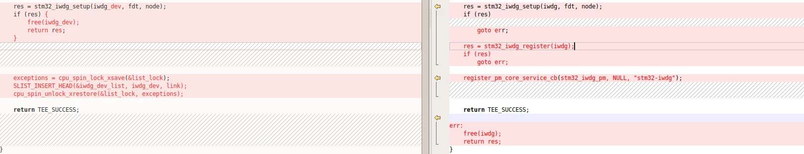

VivekBAuthor
Feb 18, 2025 10:32 AM UTC
Hiya,
I have found the reason why the optee code is panicing because the peripheral IWDG2 is being registered as SHRES_SECURE whereas the register_periph_iomem() expects it to be in SHRES_NON_SECUREstate.
There is aa major difference how watchdog used to be probed in optee-os_3.16.0 and now in the current optee-os version 4.0.0-stm32mp
In the file: stm32_iwdg.c
Function: stm32_iwdg_probe
I/TC: VBDBG: Primary CPU initializing
I/TC: VBDBG: Calling boot_primary_init_intc()
I/TC: VBDBG: Calling init_vfp_nsec()
I/TC: VBDBG: Calling init_tee_runtime()
I/TC: VBDBG: Entering init_tee_runtime()
I/TC: VBDBG: Initializing TA RAM via core_mmu_init_ta_ram()
I/TC: VBDBG: Initializing RAM console via ram_console_init()
I/TC: VBDBG: Calling preinit functions via call_preinitcalls()
I/TC: VBDBG: Calling initialization functions via call_initcalls()
I/TC: RCC is non-secure
I/TC: WARNING: All debug accesses are allowed
I/TC: VBDBG:core/drivers/stm32_iwdg.c:stm32_iwdg_probe:617: calling stm32_iwdg_register
I/TC: VBDBG:core/drivers/stm32_iwdg.c:stm32_iwdg_register:586: calling stm32mp_register_secure_periph_iomem
I/TC: VBDBG:core/arch/arm/plat-stm32mp1/shared_resources.c:stm32mp_register_secure_periph_iomem:356:
I/TC: VBDBG: Attempting to register peripheral base: 0x5a002000, state: 1
I/TC: VBDBG: Registering non-secure IWDG base: 0x5a002000
I/TC: VBDBG: Unexpected state: 1 for base 0x5a002000
E/TC:0 0 Panic at core/arch/arm/plat-stm32mp1/shared_resources.c:339 <register_periph_iomem>
E/TC:0 0 TEE load address @ 0xde000000
E/TC:0 0 Call stack:
E/TC:0 0 0xde003d99
E/TC:0 0 0xde01a7b1
E/TC:0 0 0xde0059a1
E/TC:0 0 0xde00cb97
Can someone please have a look and advise please?
Boot log here: file:///home/vivekb/optee_boot_issue_log.txt
Many thanks
Best Regards,
Vivek
GatienC
GatienCBest answer
Feb 18, 2025 3:06 PM UTC
Hello Vivek,
The CFG_DRAM_SIZE flag has to be aligned with the memory node that you pointed in the device tree. This is a compile-time sanity check :)
As I mentionned in a previous thread, the IWDG2 cannot be secured on stm32mp15x, the securable IWDG is the IWDG1. For whatever reason, if you want to use IWDG2 in OP-TEE, make sure that there is no
secure-status = "okay" in the IWDG2 node.
This piece of code is old and will very soon be removed.
Hope this helps,
Gatien
