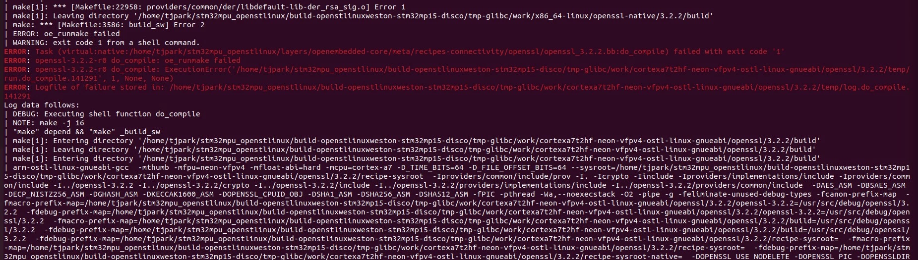

I am following the contents of STM32MPU Distribution Package in STM32 Wiki
6. Building the OpenSTLinux distribution↑.
When I build using the bitbake st-image-weston command, the following error occurs.
ERROR: openssl-native-3.2.2-r0 do_compile: oe_runmake failed
Does anyone know about the above problem? (I'm using Ubuntu 22.04.)2025-01-15 18;45;20.JPEG

Hello @parkkk ,
Did you run some cleaning step before retrying to run the bitbake ?
bitbake -c cleansstate openssl or delete temporary file for example.
Are you flowing the getting started or are you building the distribution package with custom machine or layers ?
Did you correctly follow every prerequisites found here ? Make sure to download every tool box.
https://wiki.stmicroelectronics.cn/stm32mpu/wiki/PC_prerequisites
If you can share with us more detailed logs it could help us to help you.
