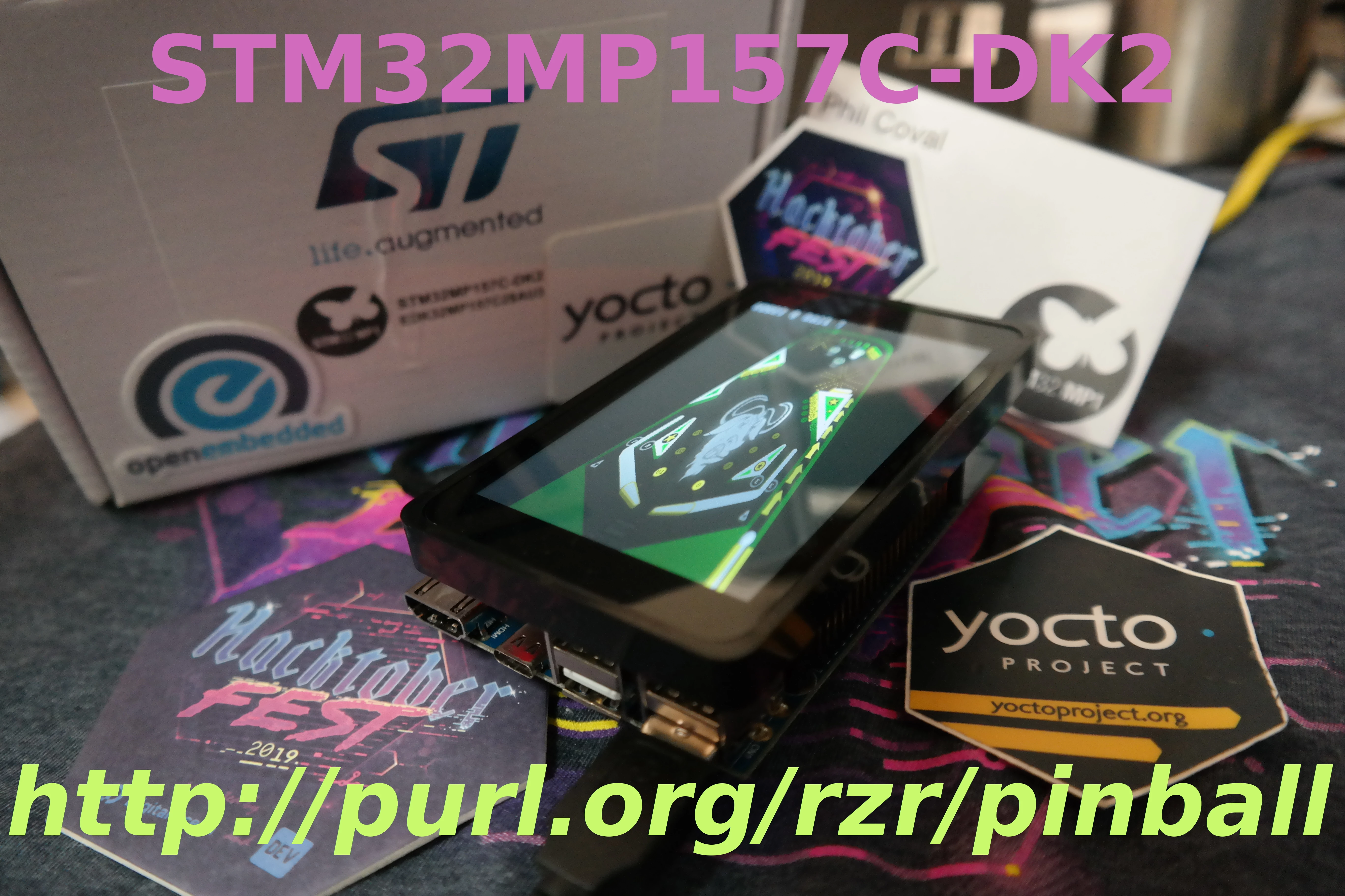

I am now trying to port an existing opengl 1.x application (not gles) so I suppose the glx backend should be used and thus mesa3d, but now I am not sure vivante blobs are supporting xorg ? @Bernard PUEL​  said x11 ? using hw acceleration ?
I just managed to deploy an opengl application to STM32MP1:
If it helps I can provide more hints:
http://purl.org/rzr/pinball#
PS: A tutorial on wiki would be welcome too
