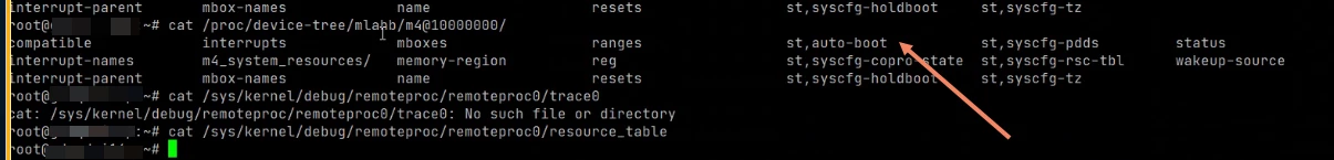

After reading most of the topics concerning my question and not finding an answer, which solves our problem, here my describtion:
We are currently integrating OpenAMP in our Application. For now, we are using the configuration from the OpenAMP_TTY_echo example project with enabled trace logs, and a single virtual UART between the M4 and the A7.
When starting the Application by using 'rproc start' in a booted linux system, it works as expected. The trace logs are available, and the /dev/ttyRPMSG0 virtual UART is loaded:
  • cat /sys/class/remoteproc/remoteproc0/state outputs 'running'
  • cat /sys/kernel/debug/remoteproc/remoteproc0/trace0 shows our debug outputs from the M4
We can send dummy data to /dev/ttyRPMSG0 and get the echoed response
In our use case we need the M4 Application to start as early as possible, so we have configured u-boot SSBL to load the ELF file and start the M4 execution. We are then facing the problem that the software is started, but the linux kernel does not load the /dev/ttyRPMSG0 device:
  • /sys/kernel/debug/remoteproc/remoteproc0/trace0 is not loaded
  • cat /sys/kernel/debug/remoteproc/remoteproc0/resource_table is empty
  • /dev/ttyRPMSG0 is not loaded

Can you please confirm you followed all instructions in
https://wiki.st.com/stm32mpu/wiki/How_to_start_the_coprocessor_from_the_bootloader
Can you confirm you are using 'st,auto-boot' in kernel dt ?
Seems indeed that issue come from resource table allocation issue when your code exceed MCU RAM1 size ( 128KB).
I need to escalate to some expert and I come back to you.

Hello Olivier,
thank you for your hint but I unfortunately have to confirm, that we double checked the wiki part.
Yes, we are using the 'st.auto-boot' in kernel dt.
After some more investigation, we also observed, that in DDR the *.elf file loaded in bad case, the data differs from the original one compiled (especially the last part of the *elf file) but in the "Tamper" register, the correct address of the ressource table is located so the parsing was correct?
Hopefully you have some other parts to check by us or directly an idea, what goes wrong in our case.

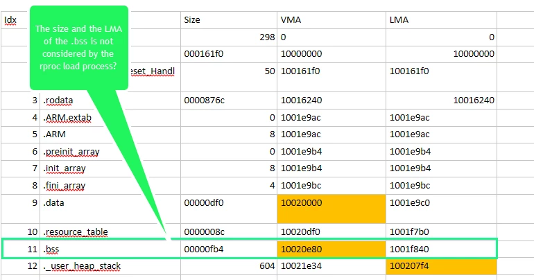

After several iteration with you using private message to get complete details about your project we are in position to explain the issue.
The issue comes from an overlap between the code (mtext) and data(m_data) memory section.
the linker script examples defines followings region:
/* Memories definition */
MEMORY
m_interrupts (RX) : ORIGIN = 0x00000000, LENGTH = 0x00000298
m_text (RX) : ORIGIN = 0x10000000, LENGTH = 0x00020000
m_data (RW) : ORIGIN = 0x10020000, LENGTH = 0x00020000
m_ipc_shm (RW) : ORIGIN = 0x10040000, LENGTH = 0x00008000
Your project was based on this definitions but with additional code when you . the elf resulting is mapped as following:
Sections:
Idx Name Size VMA LMA
0 .isr_vector 00000298 00000000 00000000
1 .text 000161f0 10000000 10000000
2 .startup_copro_fw.Reset_Handler 00000050 100161f0 100161f0
3 .rodata 0000876c 10016240 10016240
4 .ARM.extab 00000000 1001e9ac 1001e9ac
5 .ARM 00000008 1001e9ac 1001e9ac
6 .preinit_array 00000000 1001e9b4 1001e9b4
7 .init_array 00000008 1001e9b4 1001e9b4
8 .fini_array 00000004 1001e9bc 1001e9bc
9 .data 00000df0 10020000 1001e9c0
10 .resource_table 0000008c 10020df0 1001f7b0
11 .bss 00000fb4 10020e80 1001f840
12 ._user_heap_stack 00000604 10021e34 100207f4
The VMA is the virtual memory address, means the effective address of the code and the variable for firmware execution
The LMA is the load memory address. For code it is aligned with the VMA, for data it is defined in the m_text section and contains initial value of the variables.
The issue in this elf above, is that the ._user_heap_stack section LMA is not defined in the m_text memory area but overflow in the m_data(same for the end of the .bss section.
this results in side effect as a part of the m_data is overwrite.
The actual linker script is not warm on such problem, and should be improved.
Problem was visible only in boot from Uboot, because when from Linux the resource_table is re-initialized by linux world after M4 firmware start.
A workaround consist to carefully monitor m_text real size and shift m_data accordingly.
We are working on a clean solution.
Olivier

One last question:
  • The .text area contains therefore now the code + the initialized data? So, the rproc does not care about the LM addresses of the .bss segment because this is not filled with .text values but only zeros.
  • Otherwise, it will be like this. 128K .text segment will contain the code, the data which is initialized by the .text values AND the uninitialized data .bss (which would not make sense).
Because this would lead to much less place for the 'real' code part.

ArnaudP
September 17, 2021
hello @JMein.1​
Regarding the startup_stm32mp15xx.s, I think you are right, a memset is done to initialize the .bss.
So the check on the .bss and ._user_heap_stack is probably useless . And the LMA area in the m_text memory is not used.
So only protection on the resource table should be sufficient.
Please, could you confirm this in your link error usecase ?
In addition to have a cleaner mapping, you could declare the add "AT (ADDR (.bss)) to the . bss as follow to make the LMA address equal to the VMA in the m_data memory section.
 .bss : AT (ADDR (.bss))
