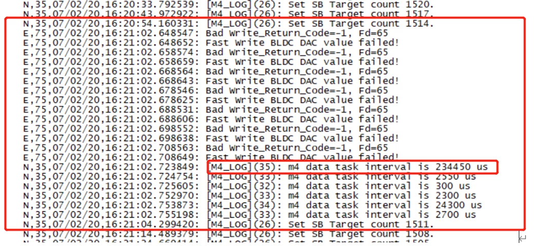

I create a process A to communicate with M4,​ another process B every 2 min will be calculate some data cost 230ms. in this inteval, process A cant use OpenAmp to send cmd to M4, until process B complete the calculation.

Could you share both process code ?
Else further explain what traces come from what process and content of each process ?
