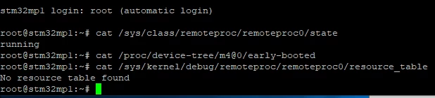

OpenAMP hangs at MX_OPENAMP_Init() when started from U-Boot, even after waited for linux to fully booted up.
When I run the openamp image through linux command prompt, the application working fine. The RPMSG devices is created successfully.
But when I've tried to run it from uboot, it stuck at MX_OPENAMP_Init(). This should be ok because I assume linux isn't running yet.
After I've tried to delay the application for one minute (assuming linux is booted up properly), it still stuck there.
I need a very-fast M4 booting, with RPMSG feature (ok to be delayed).
Hence it must be run from U-Boot. Is this kind of requirement possible?
Please help.

Olivier GALLIEN
Apr 16, 2020 9:01 AM UTC
Hi @fwajie jspa​
Indeed, the FW is blocked in OpenAMP_Init function through rproc_virtio_wait_remote_ready(vdev) until the kernel start the TTY.
If still stuck after Linux boot there 2 things to check :
1 - Linux properly detect firmware is running :
  • You should see in dmesg message « synchronizing with early booted co_procesor
    • /sys/class/remoteproc/remoteproc0/state sould be "running"
if not the case check you properly set « early-booted » option in DT Linux ( cat /proc/device-tree/m4@0/
2- resource table should be present and properly read
  • cat /sys/kernel/debug/remoteproc/remoteproc0/resource _table
you should see entry points vdev, « Vring 0 » and « Vring1 »
Else check you properly integrate a resource table in your elf.
Hope it help,
Olivier
fwajie jspa
Apr 17, 2020 9:06 AM UTC
Here is the response:
Is there something I must do to the kernel? it seems the kernel isn't ready to sync with early_boot processes

fwajie jspa
Apr 20, 2020 7:23 AM UTC
Ok, it seems the problem occured after I've update some layers in yocto. It is solved now. thanks.
