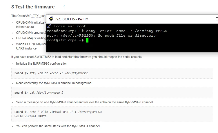

I am programming a STM32MP157C-DK2 board using System Workbench. I have been able to run the OpenAMP_TTY_echo example project without trouble. Then I created a new project and generated OpenAMP middleware from CubeMX. No trouble while compiling and uploading the firmware. But I have been able to test the firmware because of this error (see image below).
Am I missing something? Please share any hint that could help!

Hi @Community member​
/dev/ttyRPMSG0 is only created after call to VIRT_UART_Init(&huart0) ... which is not part of code generated automatically by CubeMX.
Hope it help,
Olivier

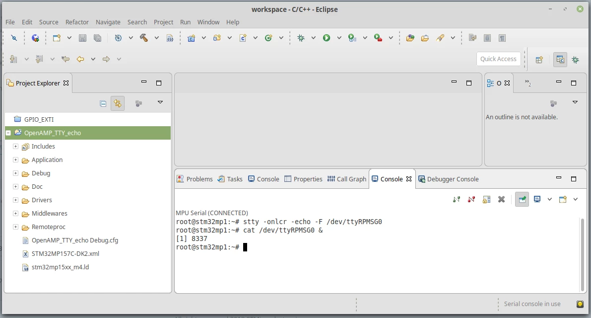

djimel
Jul 22, 2019 12:40 AM UTC
Hello, I tried it on my PC it works well, I think you have to try it with System Workbench for STM32.
1- Connect the card to the PC
2- Download the firmware

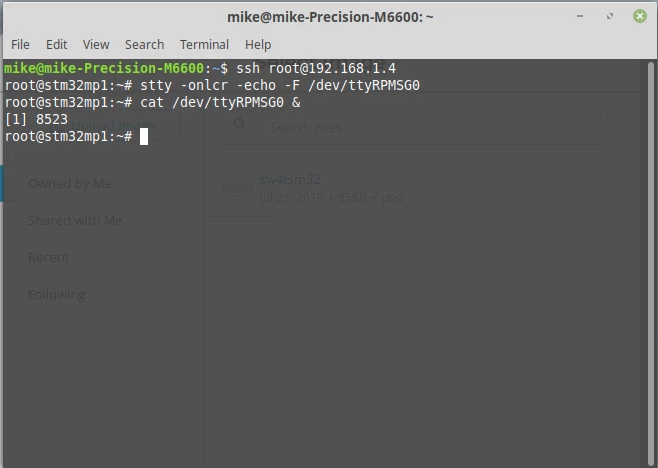

I also tried it with SSH instead of the System Workbench console.
And it works:
Thank you
