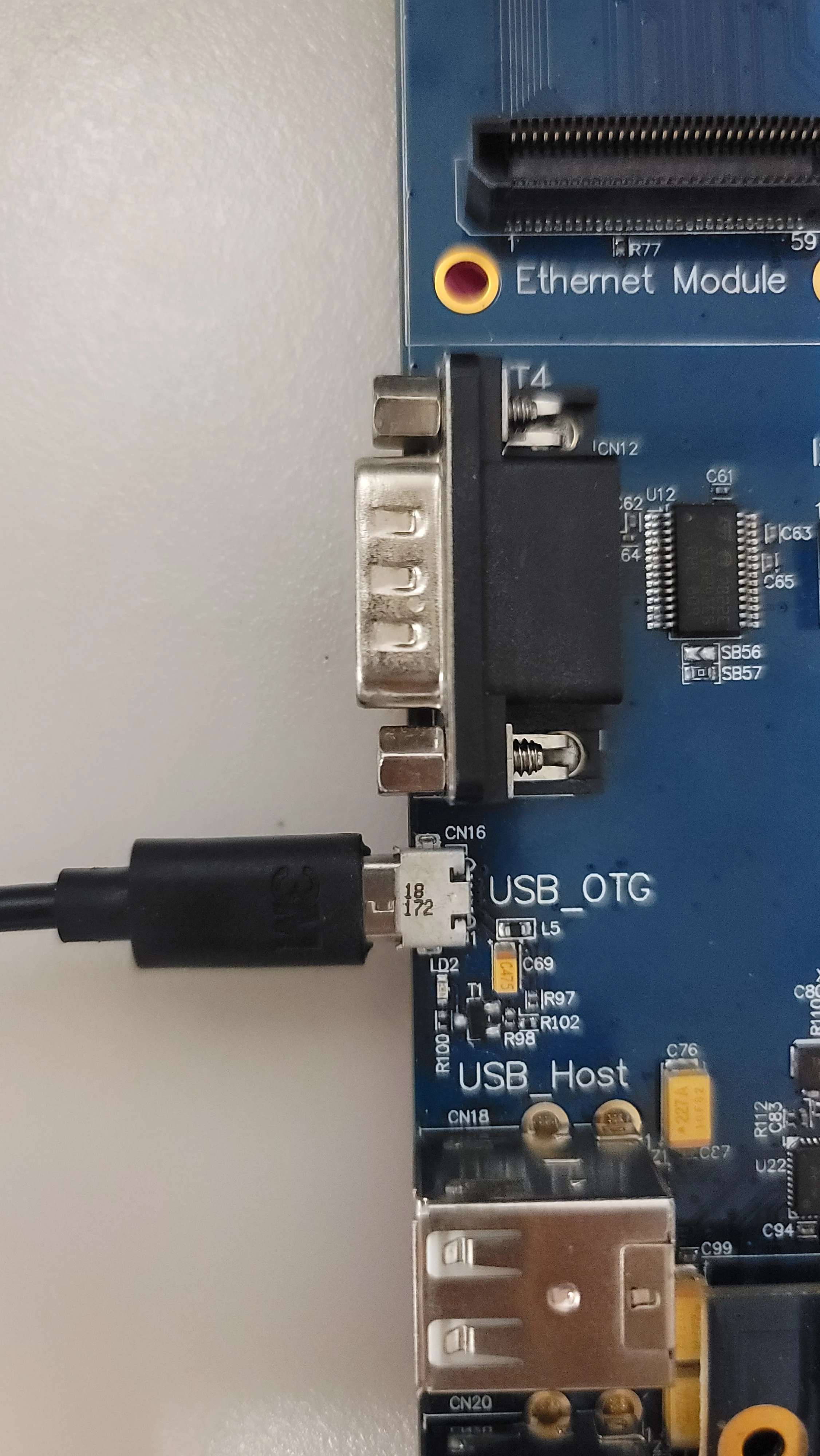

First, The board I am using is the STM32MP157D evaluation board.
I checked the article that the starter package can be installed in Windowsos, but the developer package and the distribution package are only available in the Linux environment.
In addition, Ubuntu 18.04 was installed on VMware as Ubuntu 20.04 LTS because it may not be compatible.
I installed the virtual environment and the STM32Cubeprogrammer Tool, and I tried to connect with virtual Linux by booting the board in USB mode, but the STM32 tool on Linux cannot find it.
By installing another USB device on the PC, we confirmed that the USB driver works normally.
The STM32Cubeprogrammer version is seen as API v2.12.0 | Linux-64bits.
How can I connect to the STM32MP157D-EV1 board and USB in a VMWare Linux environment (Ubuntu 20.04 LTS)? Please give me a hint.

Hi @kKim.1​,
From your question I understand you might be at this step of the Getting Started :
Populate the target and boot the image - stm32mpu
Which USB port of EV1 board do you connect to PCs ?

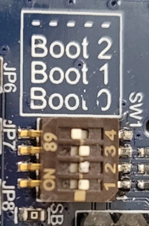

You might use USB_OTG port from mother board CN16 and all boot pin to 0 ( USB boot mode)
"In addition, Ubuntu 18.04 was installed on VMware as Ubuntu 20.04 LTS because it may not be compatible. "
Please refer to https://wiki.st.com/stm32mpu/wiki/PC_prerequisites
Ubuntu 20.04LTS is the recommended one.
Hope it help,
If those hint does not unlock you please provide screen shot or logs.
Olivier

I use the USB port of CN16's USB_OTG port. This port has been used to verify that it is connected in Windows OS. And I checked that VMWare-Ubuntu 20.04 is not connecting.
I am attaching a picture of the used USB port and boot mode.
