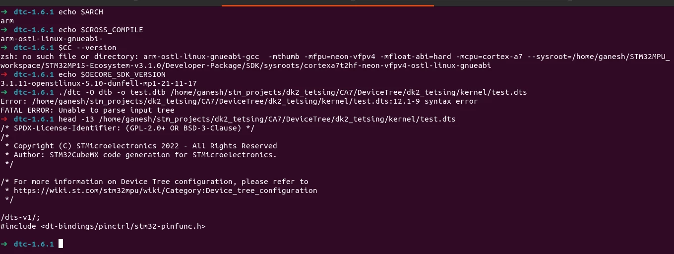

Not able to compile dts file
  • June 9, 2022
  • 1 reply
  • 1046 views
I have installed the developer package and activated the same
but not able to compile dts files
following are the commands I have used with the first 13 lines of dts file

Hi @Ganesh​ ,
Can you please refer to How to compile the device tree with the Developer Package - stm32mpu
I suspect error come from you try to build dts from a custom folder
It has to be in kernel/kernel-sources/arch/arm/boot/dts/ in order to be compiled.
Hope it help
