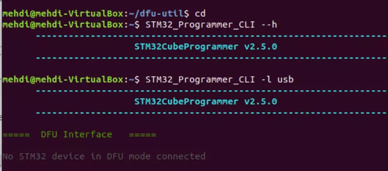

no stm32 device in dfu mode connected
Hello Everyone
I wanted to connect my STM32MP157-DK2 to laptop (Ubuntu 18.04 through a VM). I followed every step in the bellow article but nothing : https://wiki.st.com/.../STM32MP15_Discovery_kits...
According to section 6.2 my MP should connect. The STM32Programmer Software is responding (Version 2.5) but the USB connection isn't possible
The switches are on the Off mode.
There is no explanation on the net, so I hope that you can help me.
Thanks

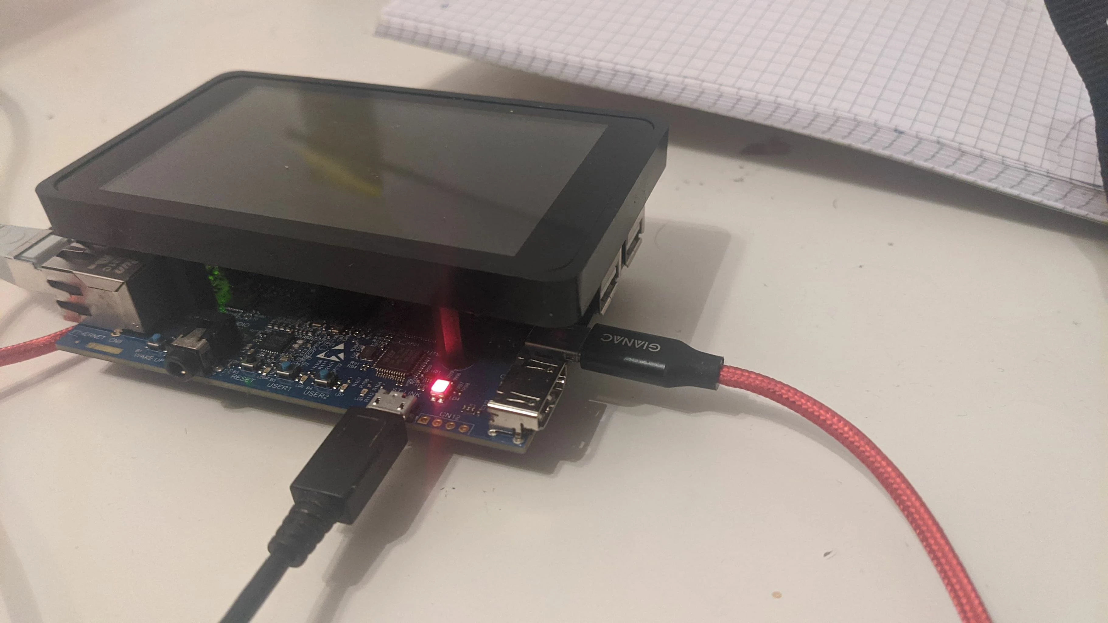

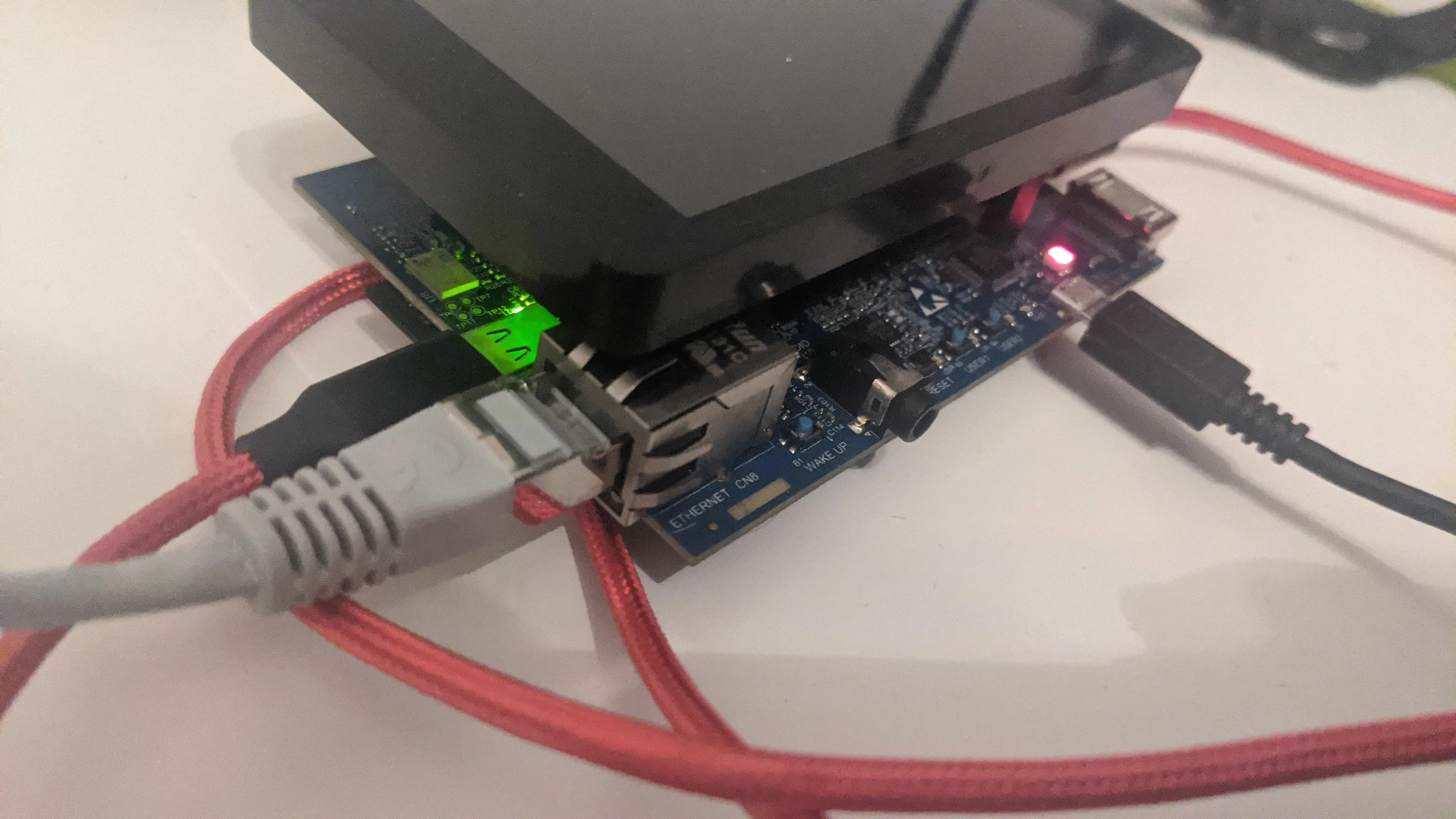

SigmaPrime
Oct 17, 2020 17:29 UTC
Hello
Sorry I wasn't home during the weekend
I'm gonna try it now and see if it works thanks.
SigmaPrime
Oct 17, 2020 17:31 UTC
It still does not work ..
