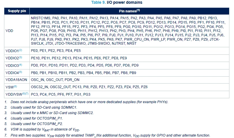

Have you tried ‘gpioinfo’ as you cannot control a GPIO which is already ‘used’ by another Linux process
notice that PE0 to PE5 are belonging to VDDIO1 domain which need to be supplied but also ‘enabled’ in the SW (usually assigning active peripherals to at least one of those pins inside Device Tree might be enough).
Regards.

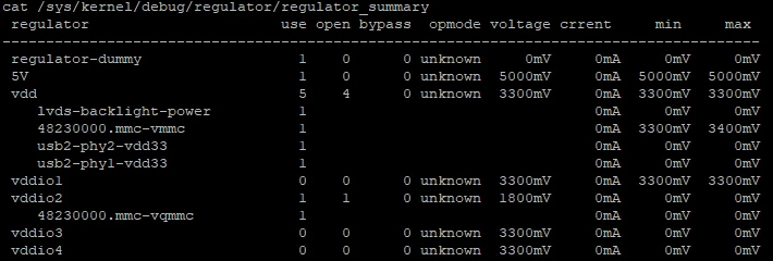

Also, I have some GPIOs and UARTs on PD/PB pin and powered by Vddio3-4.
After the boot I get :
[   35.805443] vddio3: disabling
[ 35.805521] vddio4: disabling
Why does the used port is shown as unused and unpowered ?
I have also added ‘regulator-always-on;’ for vddio3-4 in the device tree, it doesn’t change anything.

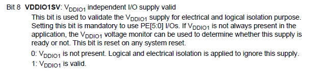

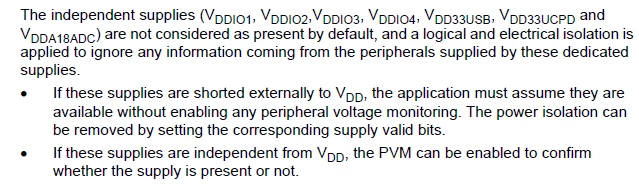

PatrickF
PatrickFBest answer
Jul 29, 2026 12:29 PM UTC
I’m not SW expert, but Linux could ask the system for ‘disabling’ a regulator (e.g. no Linux running driver use the related supply), but OpTee (which manage the powers and clocks) has it owns rules defined in it’s DT (e.g. always-on).
For PE0-5, maybe dump the PWR_CR8.VDDIO1SV bit value using devmem2 for instance (if read is allowed from user space)
devmem2 0x5421001C word
But if no device is associated to any of VDDIO1 PE0-5 pins, it is maybe normal that OpTee (or Linux?)  does not set VDDIO1SV bit.
