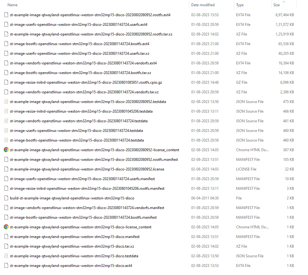

Hi Community,
I realise that this may be a very newbie question:
I have run all the steps as seen on the Wiki,
I followed these steps to the letter: https://wiki.st.com/stm32mpu/wiki/PC_prerequisites
Folowed by:
mkdir -p st/build
cd st/build
repo init -u https://github.com/STMicroelectronics/oe-manifest.git -b refs/tags/openstlinux-6.1-yocto-mickledore-mp1-v23.06.21
repo sync
DISTRO=openstlinux-weston MACHINE=stm32mp15-disco source layers/meta-st/scripts/envsetup.sh
bitbake st-example-image-qtwayland
All these steps were completed successfully :heavy_check_mark:
I'm looking at the tmp-glibc/deploy/images/stm32mp15-disco/ directory and I am unable to figure out which of these I need to flash on to the SD card using etcher on my PC.
Could someone help point me in the right direction?
Thanks,
Erwan SZYMANSKI
Erwan SZYMANSKIBest answer
August 2, 2023
Hello @BarryKingLive ,
Here you are supposed to have a flashlayout_st-example-image-qtwayland folder, containing optee folder and itself containing the different TSV files that have been generated if everything were going well in your compilation step. This TSV file can be directly used with CubeProgrammer following Wiki information, or you can use the script located in tmp-glibc/deploy/images/<st_platform>/scripts as follows:
./create_sdcard_from_flashlayout.sh ../<your_flashlayout>/optee/<your_TSV>
I hope it will help you to go forward.
Kind regards,
Erwan.

August 2, 2023
Thanks Erwan!
This did the trick.
