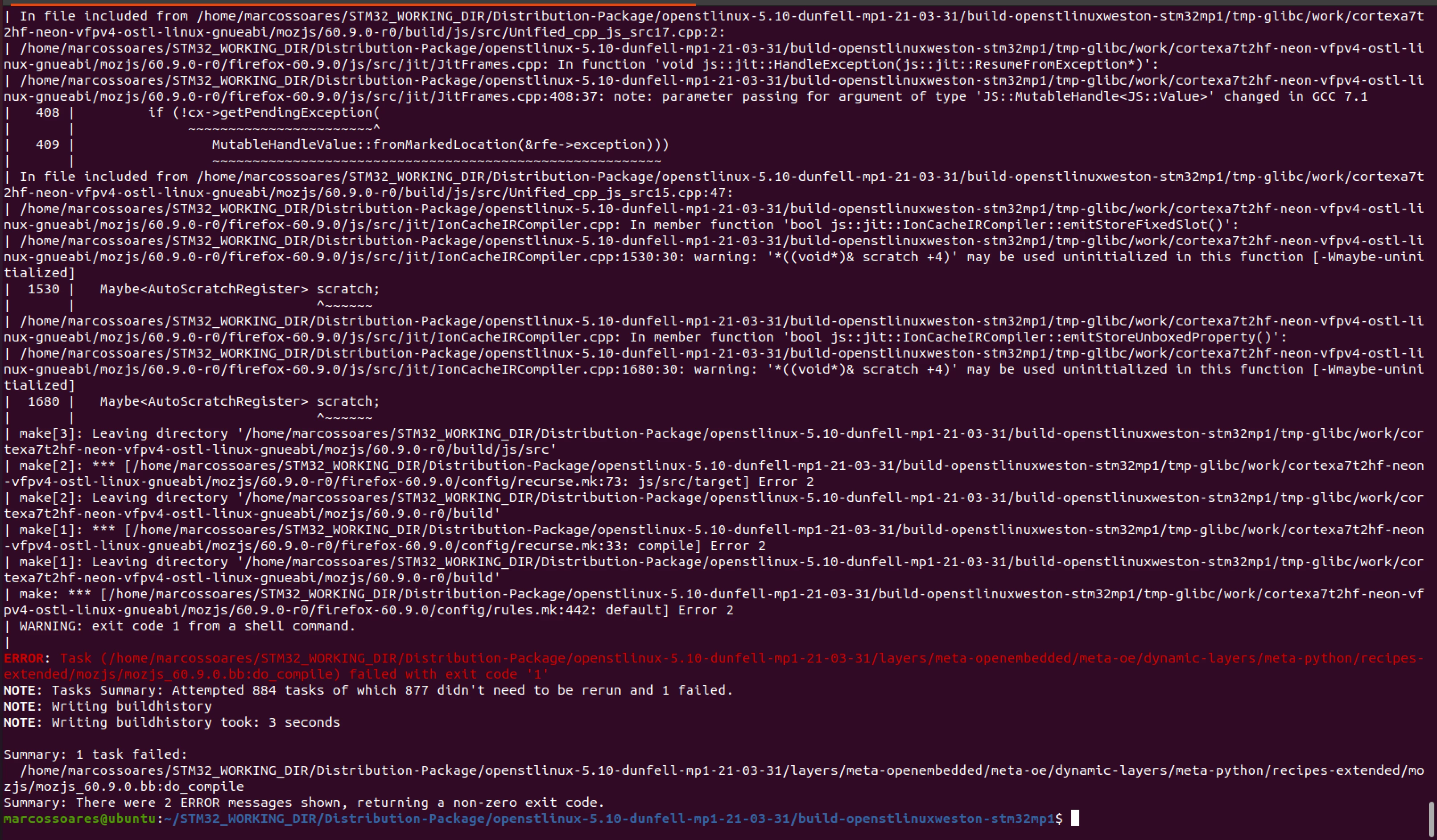

mozjs_60.9.0.bb:do_compile failed with exit code '1 - Cant Compile Distribution Package (SOLVED)
I've followed all the steps from:
https://wiki.st.com/stm32mpu/wiki/STM32MP15_Discovery_kits_-_Starter_Package
https://wiki.st.com/stm32mpu/wiki/PC_prerequisites
https://wiki.st.com/stm32mpu/wiki/STM32MP1_Distribution_Package
Creating openstlinux-5.10-dunfell-mp1-21-03-31 distribution installation,
with bitbake st-image-weston, error rises:
(..layers/meta-openembedded/meta-oe/dynamic-layers/meta-python/recipes-extended/mozjs/mozjs_60.9.0.bb:do_compile) failed with exit code '1'

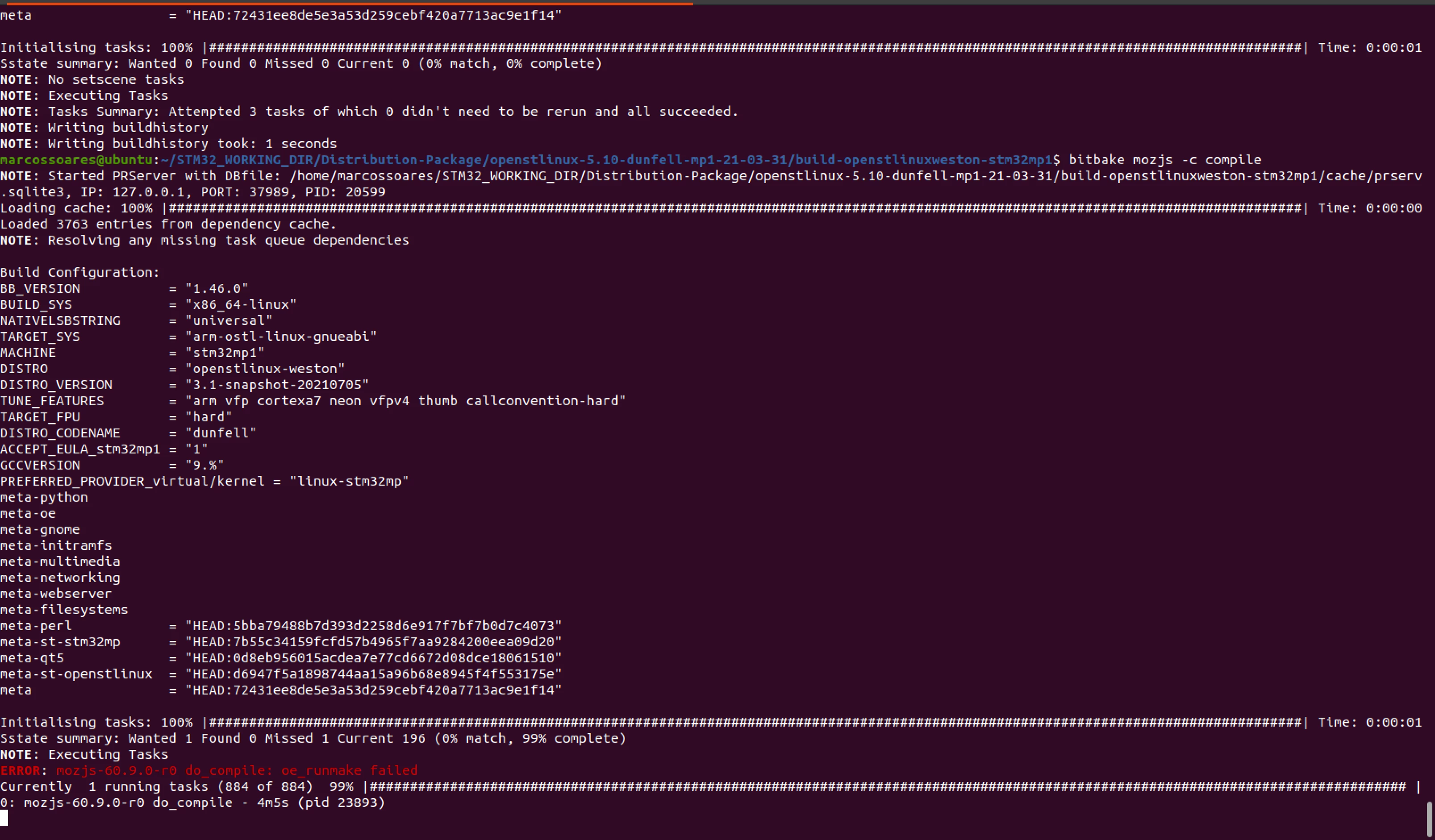

Tried:
bitbake -b mozjs -D -f
bitbake mozjs -c cleanall
bitbake mozjs -c compile
but the same error occurs.
