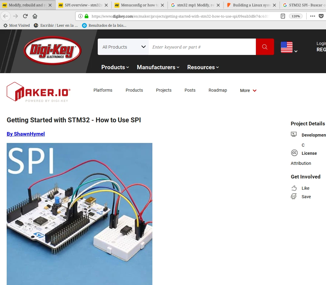

Reading about this first device I saw that example code0693W00000Y9WGtQAN.png won't work there but I should use spidev on openstlinux ( wiki st com stm32mpu wiki SPI_overview ). However, in order to spidev get to work is needed to select the port name (i guess)... the case is:
/sys/bus/spi/devices and /dev/spi* have "N-O-T-H-I-N-G":pouting_face: although the port is physically installed >:( . Really I don't know what is the meaning of creating a image for this device if this will no recognize all of the present hardware :fearful_face:.

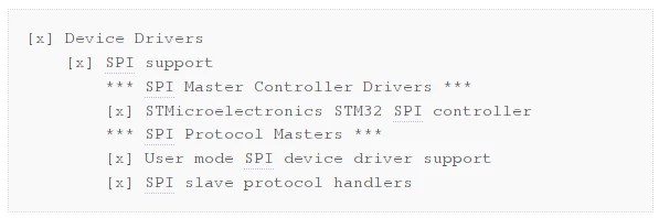

Thanks for your help, however the device is still hanging after followed each and every one of the steps. In this time I didn't changed the .config file manually but I used "make menuconfig" and there it showed a tree menu where I selected the options specified by https://wiki.st.com/stm32mpu/wiki/SPI_overview (3.1 Kernel configuration). All of the commands finished without errors; when the device was rebooted ( https://wiki.st.com/stm32mpu/wiki/Getting_started/STM32MP1_boards/STM32MP157x-DK2/Develop_on_Arm%C2%AE_Cortex%C2%AE-A7/Modify,_rebuild_and_reload_the_Linux%C2%AE_kernel ) according to "5.4 Reboot the board", it gets hanged for ever. I don't know what to do anymore, it really is a bad joke to sell a device with unusable hardware components, if the SPI port is too much to ask, then at least don't mention it in the device features.
I appreciate any ideas or guidance on getting this thing to do what it claims to do, thanks.

Hola :), I marked exactly this, nothing more than this:
0693W00000Y9j1mQAB.pngI didn't get errors, at least I didn't see them. I can repeat the process and catch all console output in a text file and upload it if you want.
