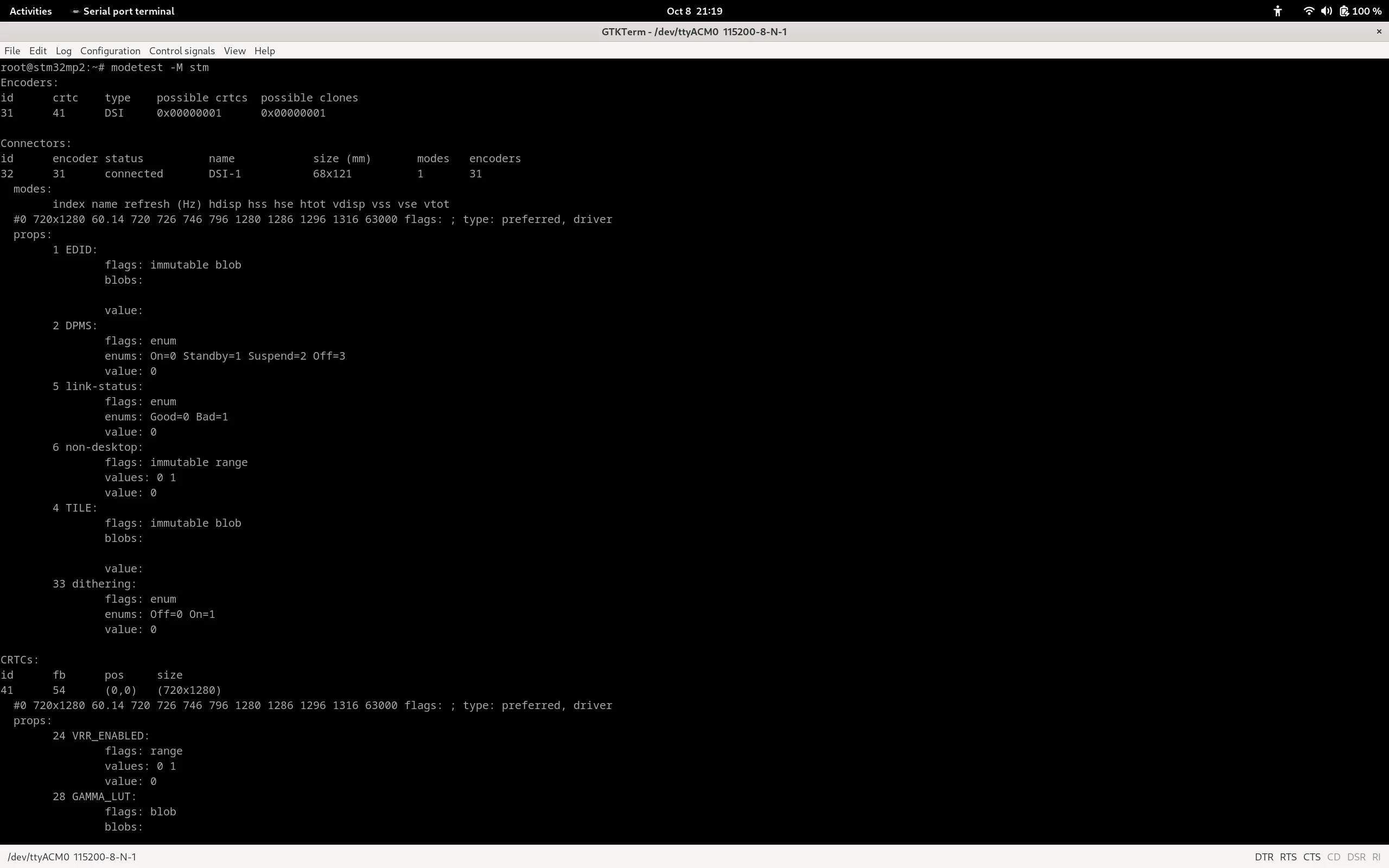

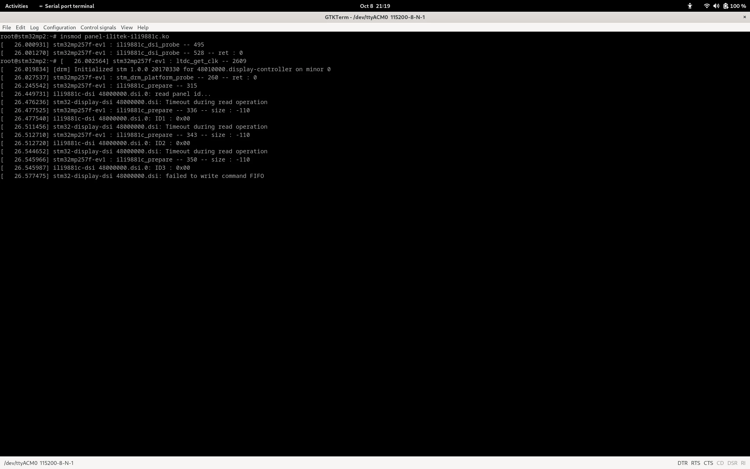

Thanks, I have solved this problem, it was because I used the wrong device tree configuration, now I upload my device tree and panel-ilitek-ili9881c.c so that others can see it in the future.
I don't connect a real panel, so it is always timeout.
the hardware design is in progress.
6 replies

So now back to my question, I think this function should run here when kernel trying to mount the display module, but in reality it does not, so how the kernel can reach here(ili9881c_dsi_probe)? I think there is no problem with the device tree, and this display can also be found in the kernel log.
CONFIG_DRM_PANEL_ILITEK_ILI9881C=y
root@stm32mp2:~# dmesg | grep ili98
[ 0.315353] platform 48000000.dsi: Fixed dependency cycle(s) with /soc@0/rifsc@42080000/dsi@48000000/ports/panel-ili9881c@0
