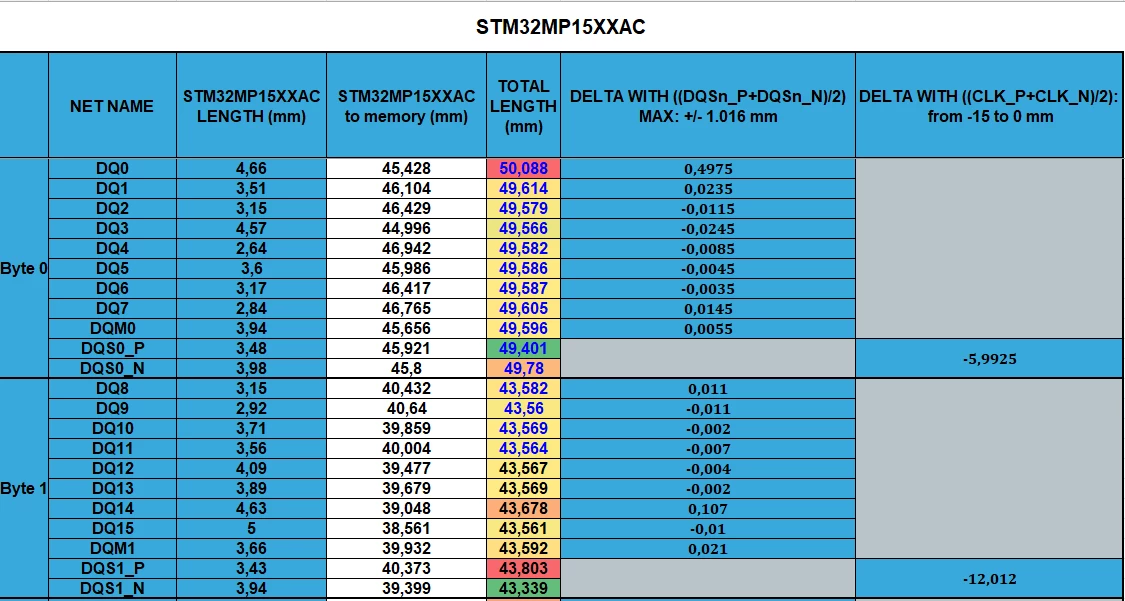

I downloaded the STM32MP151AAC3 example model (.zip file) that routes traces to the DDR3L memory
STM32MP151A - MPU with Arm Cortex-A7 650 MHz, Arm Cortex-M4 real-time coprocessor, TFT display - STMicroelectronics

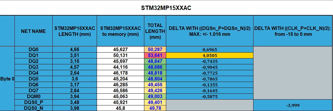

Then I measured DDR_Q1 to DDR_7, DQM0, DQS0_P and DQS0_N and filled the Excel table that is included inside the downloaded .zip file.
Here is the result:

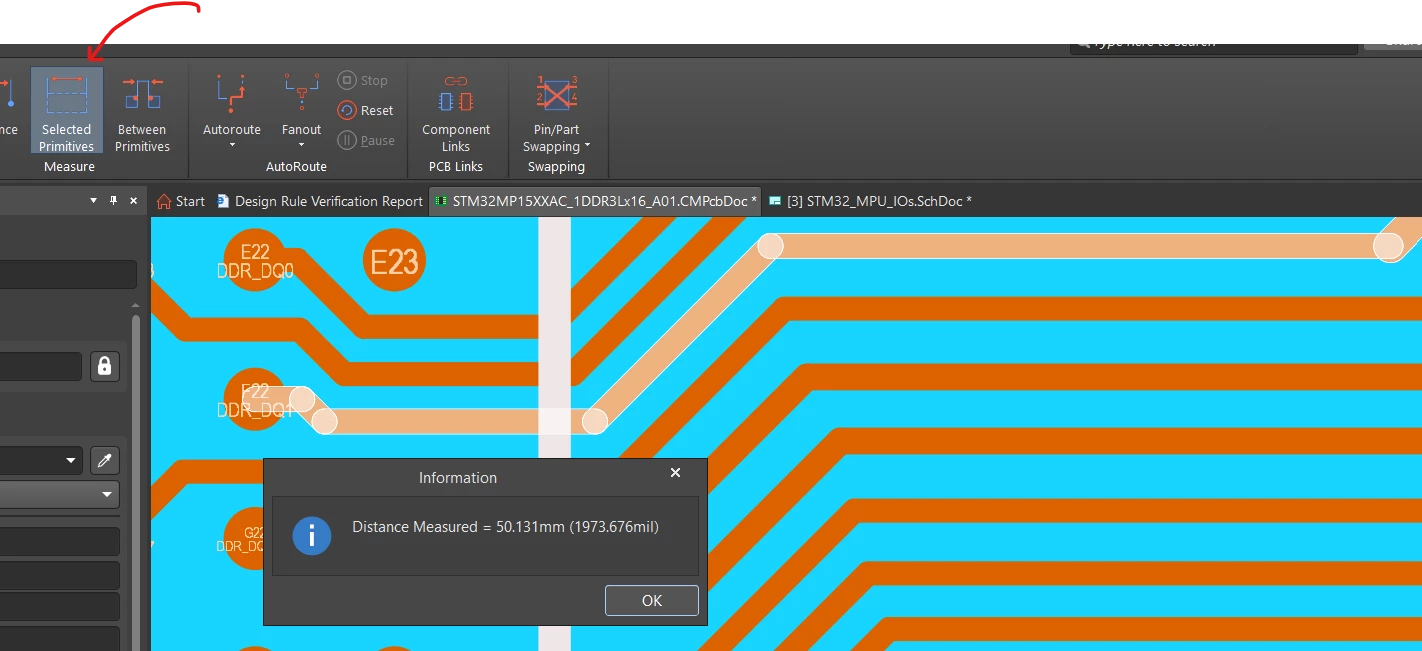

I have been using Altium CircuitMaker (very similar to Altium Designer).
I measured by first pressing CTRL+H and then mark one part of the track and then I press this button.
But when I look at the Excel spred sheet that ST have made, they show me these numbers.
My question is: What are ST doing to getting the length of DQ0, DQ1, DQ5 and DQ6 ? It seems that they are the only ones that differs. Others seems to be similar.
If they are changed in the model, but not in the Excel spred sheet, which values should I follow? The values made by ST, or the hard ware example model made by ST?

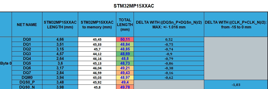

HI @DMårt
I'm not expert, but checking with Altium Designer, I see length in excel is very close to the value from the PCB file. So, no issue there
DQ1 details
Regards.

@PatrickF
Thank you!
I have re-routed the upper layer traces and it seems very promising.

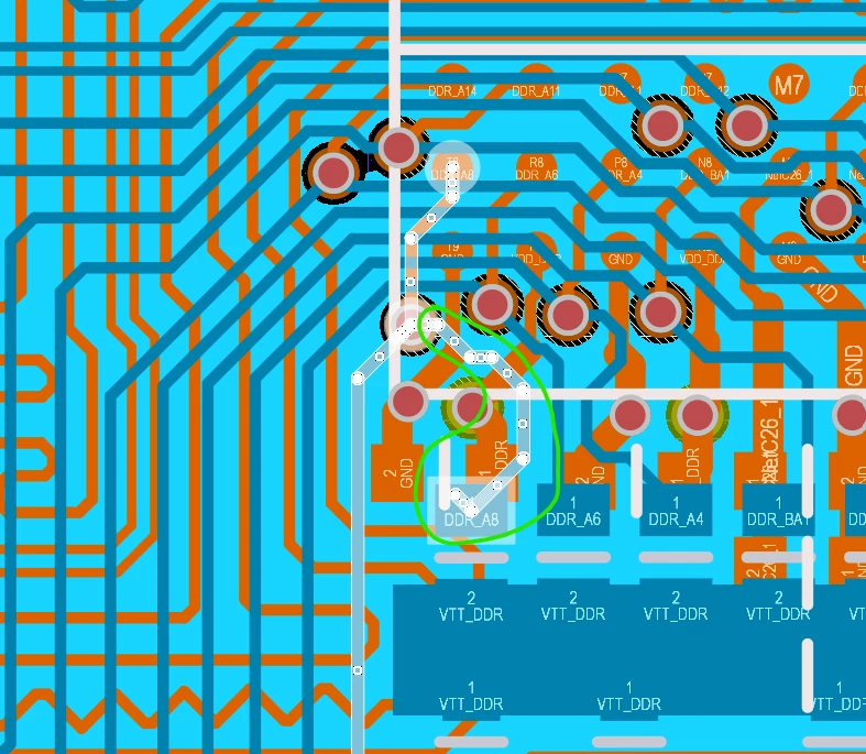

But for the lower traces, I have a question about the lengths: Should the lengths of the pull-up traces count with the lenghts of the signal traces?
Or is the only length between MCU pad and DDR pad, including PCB thickness times 2 (it's 2 vias)?

track length put in excel sheet should be calculated from MP1 to DDR (ball to ball), excluding the termination resistor track (which should be as short as possible, no length equalization).
Obviously, termination resistor track should be 'after' the MP1 to DDR track (no 'T' routing which break impedance and signal integrity). What I see above seems not good.
Quick explanation: Lenght equalization is for MP1/DDR timing propagation (i.e. signals must be sampled at right time). Termination resistors are for signal integrity (reflections).
Notice that termination resistors are optional when using a single DDR3L x 16 bits (Although we have it on our reference boards, many customers does not have it without any issues)
Regards.
