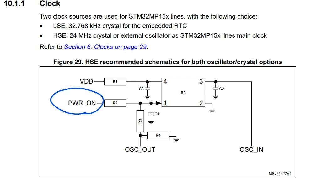

Btw, in your schematics, you might have issues around 24MHz oscillator as you need to have HSE_OUT =0 to allows BootROM autodetection of digital bypass while the oscillator usually need a logic 1 to start (i.e. PWR_ON).

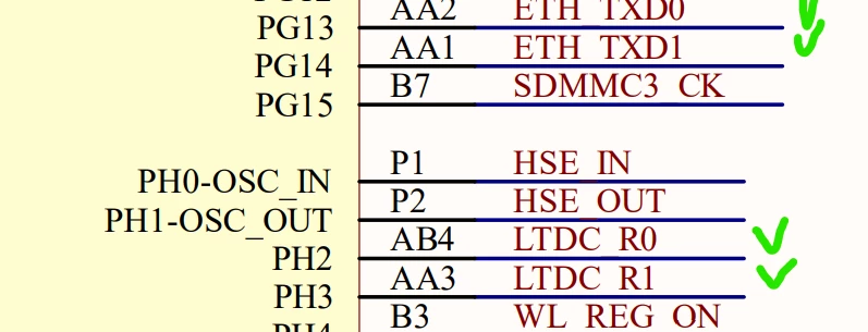

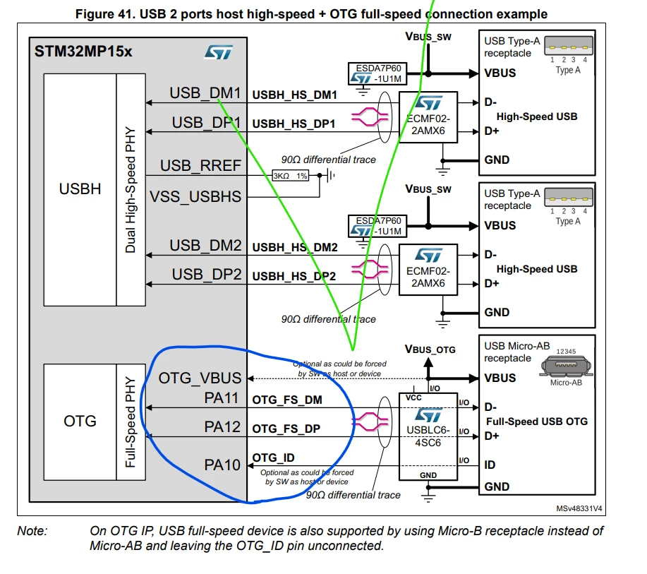

By the way! I'm using OTG_VBUS -> VBUS, OTG_FS_DM -> D-, OTG_FS_DP -> D+, OTG_ID -> ID to a Micro USB connector, instead of USB_DP2/USB_DM2. Is that prefered?

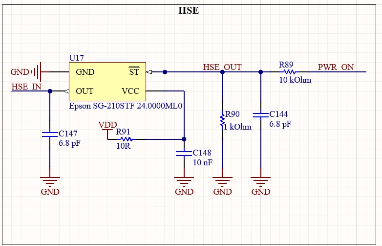

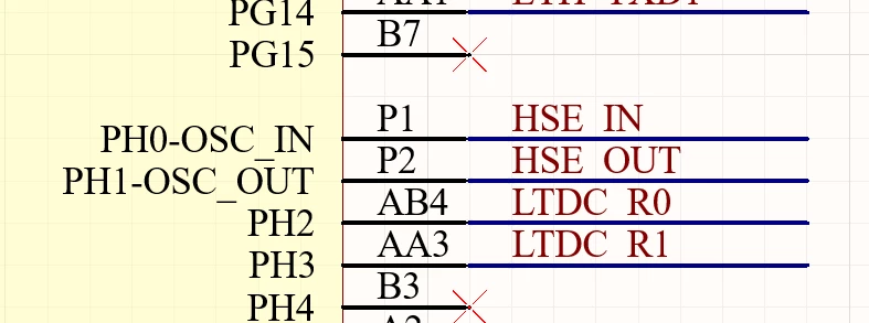

I have followed the schematic from AN5031.

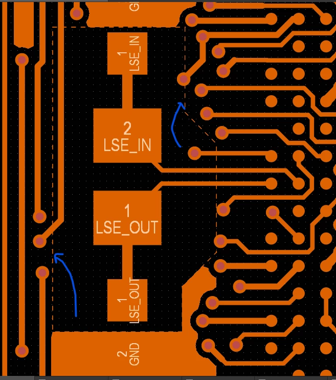

Also I have made a cut for the LSE crystal.

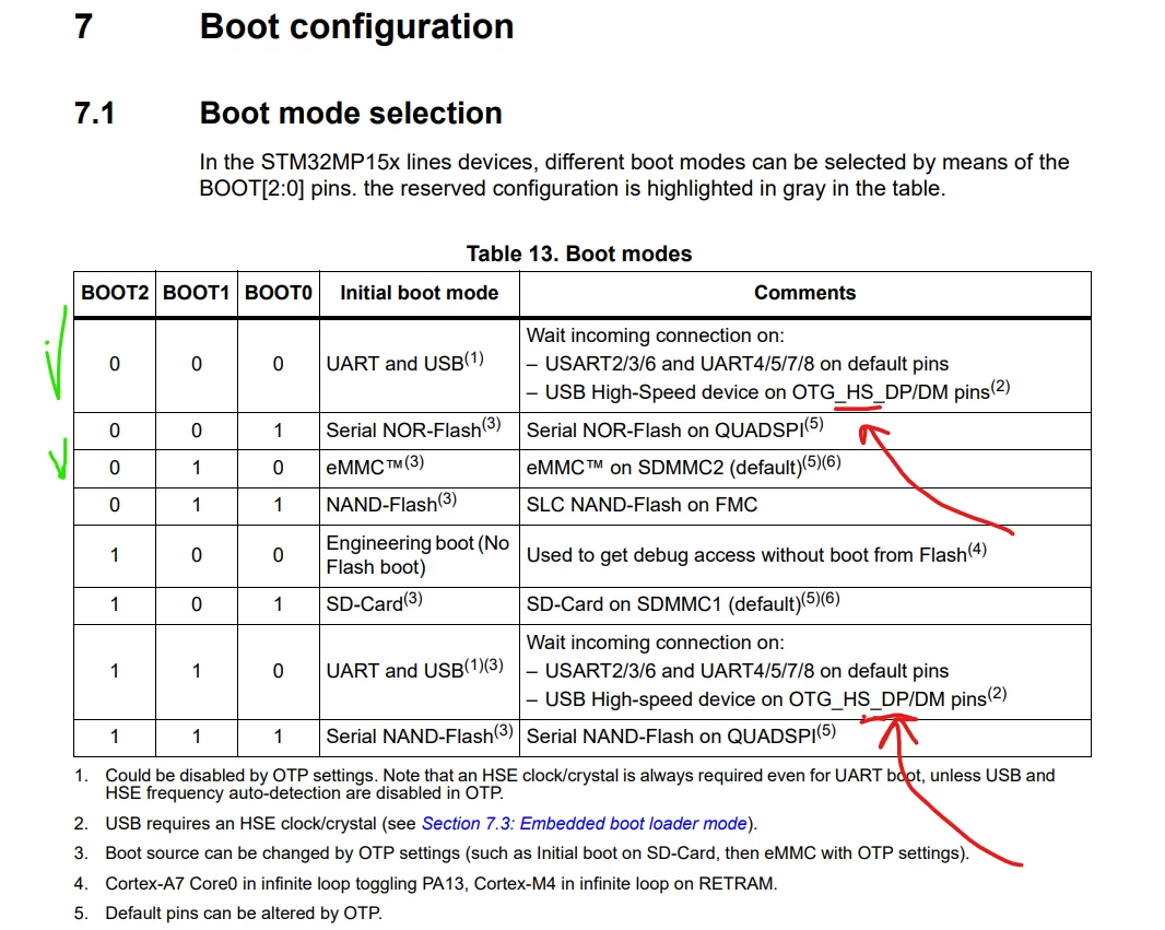

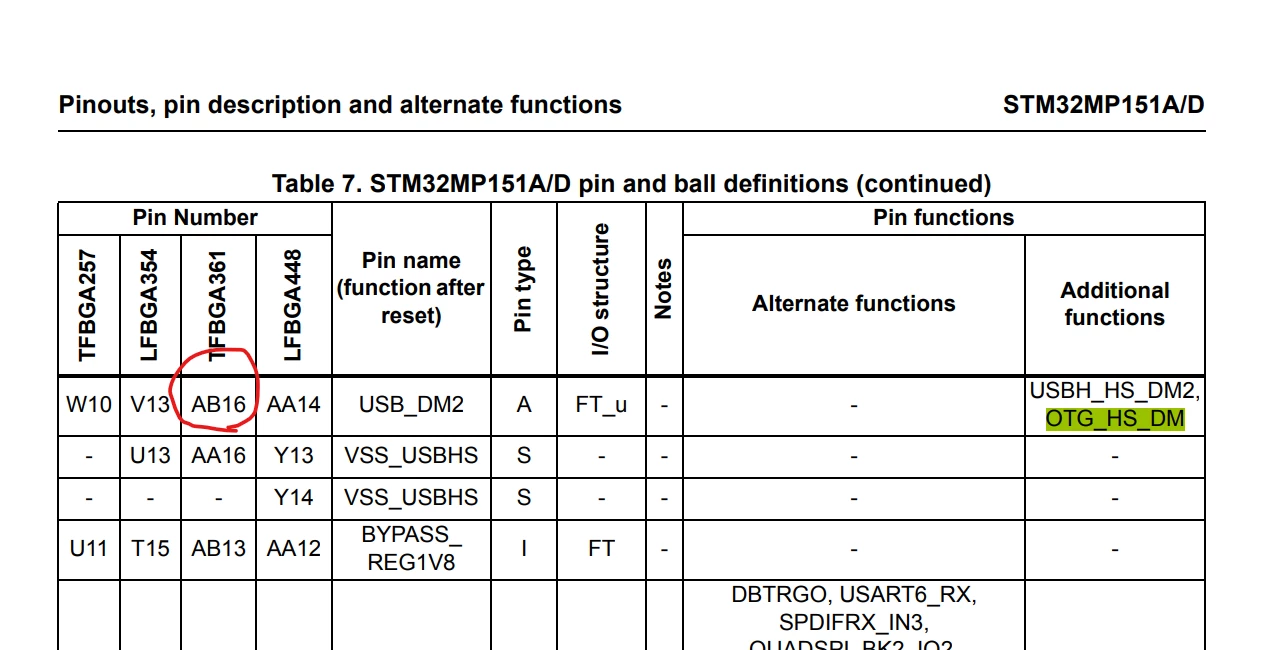

>> OTG_FS_DN/DP could be easily replaced by USB_DP2/DM2 to get high-speed and Flashload capabilities.
But is not OTG_FS important if I want to flash the eMMC with the operative system(Linux) via CubeProgrammer?
I have not found any OTG_HS_DN and OTG_HS_DP.
Edit:
I found that DM2_DP is pin AB16 and DM2_DN is AC16!
I will change OTG_FS_DP/DM to OTG_HS_DP/DM. Thank you for noticing that!

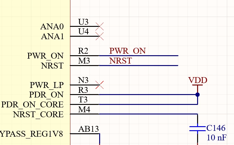

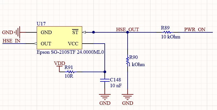

PatrickF
Apr 30, 2024 10:00 UTC
It seems the HSE oscillator is not wired as expected from AN5031 (PWR_ON and OSC_OUT are never linked, either R2 or R3 is open)
Regards

DMårtAuthor
Lead
May 7, 2024 18:38 UTC
Hi @PatrickF
Can you explain why my PWR_ON won't have any actions in my schematic?
This is from my board.
Skärmbild 2024-05-07 203348.pngSkärmbild 2024-05-07 203233.pngSkärmbild 2024-05-07 203200.png

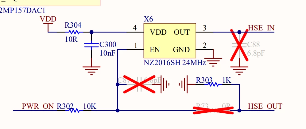

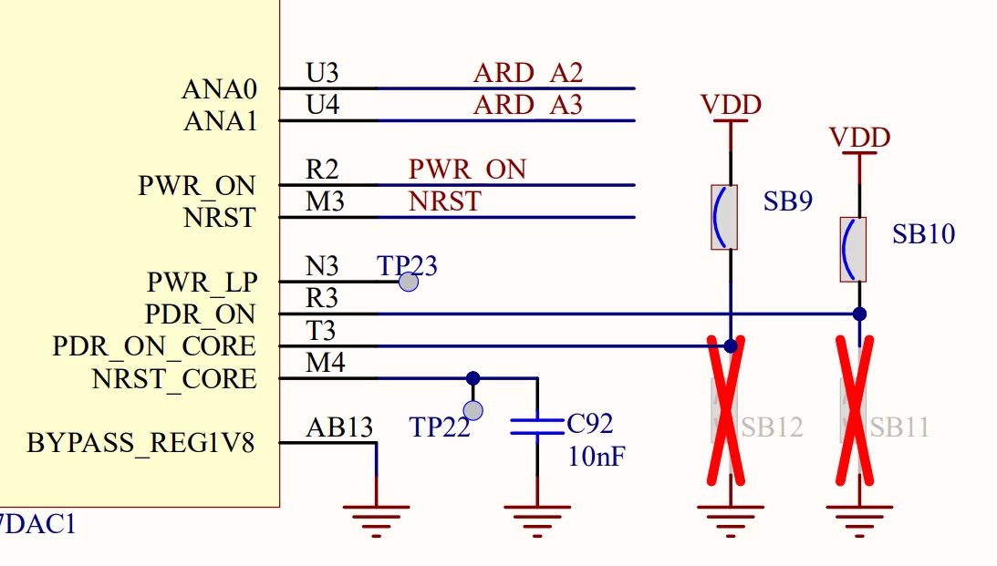

This is from the dev-kit. I assume that the zero-ohm resistor should be removed and replaced with a track only. But the capacitors should not be replaced with a track.
Skärmbild 2024-05-07 203521.pngSkärmbild 2024-05-07 203505.pngSkärmbild 2024-05-07 203448.png
