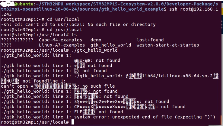

I then asked a friend for their version of the gtk_hello_world example. It runs on my linux system and was able to download it to the board. But when I run it on the target, I get a very strange error as seen in the image runSample. It's like the file(s) is corrupted...

You should restart all your compilation from scratch, for us , following ST example works fine!
You could check with "file" utility the target system of the compiled executable:
file myprog
myprog: ELF 32-bit LSB executable, ARM, EABI5 version 1 (SYSV), dynamically linked, interpreter /lib/ld-linux-armhf.so.3, for GNU/Linux 3.2.0, BuildID[sha1]=7c904aa5512330fc92fa138ffd493adbd3a5218b, with debug_info, not strippe
By the way, the gtk_hello_world is made for DK2 GUI isn't it? not a command line executable.
