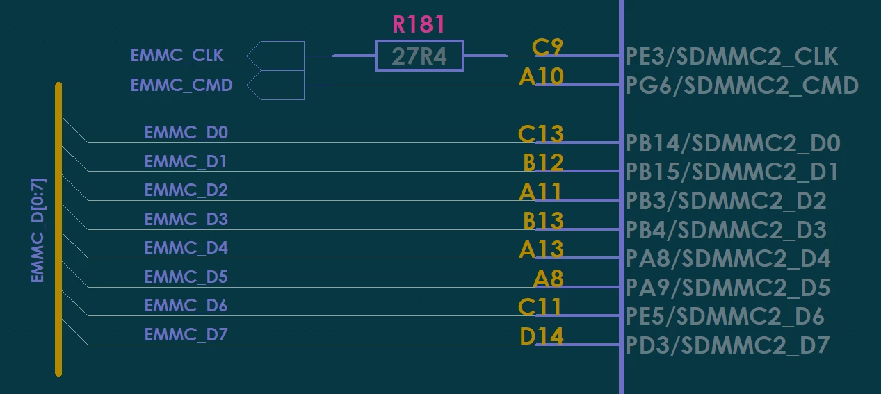

We are currently experiencing a major issue with eMMC on our custom boards using STM32MP153CAC. Our boards are booting normally with 1 wire mode, but as soon as 8 wire/bit mode is enabled, it starts to bug out.
Here is the description of the problem from our linux developer:
- Starts up on 8 bit bus width, but
- Does not stay at 8 bit bus width
- And after it falls back to 4 bit, it tries to switch back to 8 bit, but fails
- The clock seems to "only" be 27 MHz, and not 52 MHz
- The actual read and write speed is lower then it should be, 8 bit DDR52 should be around 50 MByte/s read and 30 MByte/s write
but it looks to be more around 2-3 MBytes/s
- Read and write bigger file seems to prevoke the from 8 bit to 4 bit
- If configured to start at 4 bit DDR52, fallback 4 bit mmc high-speed (not DDR)

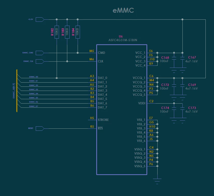

Here is information about the PCB:
- 8 layer
- We only use 3.3V for the emmc, on both power domains
- Here is how the emmc is connected

No series resistors? Usually designs have 27R or 33R to stop ringing. Traces also need matched lengths.
DDR implies data on both clock edges. DDR104 would have 52 MHz clock, not 104 MHz, although clock within peripheral will likely be higher internally.
Throughput on eMMC dictated by device, different brands have different performance.

January 10, 2024
Only series resistor on EMMC_CLK line. (See attached photo below)

Failure suggests you have a signal integrity issue, and perhaps skewing of different data lines vs clock.
Would look critically at path lengths and drive strength settings. On the MCU series SPEEDR can be reduced on short trace, low load pin paths.

Hi @JOhn1 ,
27 MHz whereas 52MHz requested might depend on which combination the driver has found be not be above the 52MHz. Could you please share clock summary.
cat /sys/kernel/debug/clk/clk_summary
I think the issue of 8-bit to 4-bit is not linked to 27MHz clocking.
Did you have checked signal/power integrity on your board ?
Is the serie resistor on SDMMC2_CLK close to signal source ?
Is the eMMC far away from STM32MP15x ?
Did you enable more log from related Linux driver to see if there is details/explanation of the fallback from 8-bits to 4-bits ?
Could you share the eMMC reference you are using ? Did you tried another brand ?
For read and write performances, it depend on the memory itself, the driver efficiency as well as processor load.
Regards.
Yes, according to our EDA tool, 3.75 mm from pad to pad. The series resistor is on same layer as IC, so getting it any closer would require us to move it to the opposite side.
Each trace is matched withing 10 mil (0,254 mm) and each trace is 27,7 mm long (CLK, CMD D0-D7).
The layout is according to the the reference design in AN5031 rev4.
It is our first design using eMMC, as we have many tens of thousands products using raw NAND flash, which also since transitioning to STM32mp153 have worked well. The particular emmc used is ASFC4G31M-51BIN from Alliance.
