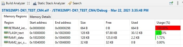

It was harder for me to understand what will be available for the M4 (where most our processing will be). I decided to build a simple project and take a look at the resources available (to make sure we have at least 256 kb of RAm to work with so we can port a good chunk of code over from the WB55. When I looked at the resources available, i was a bit confused:
0693W000008xcgoQAA.jpgI'm not sure how the above description correlates to the current settings. Is the RAM configuration customizable to I can allocate more RAM to the M4? if so, is this something that's done in the IDE or would I make the changes in the linker file?

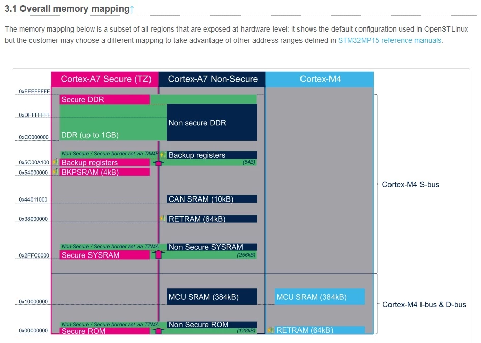

I was able to find this on that page you sent me (once again, thanks for that, great reference!)
0693W000008xchDQAQ.jpgIt does look like it should have 384 kb of SYSRAM, which I believe would be the equivalent of what I was using with the WB55. I'm looking through the IDE and the reference guide and I'm not really putting the pieces together of how it's configured or how the above settings in the IDE correlate with the diagram above. How do the above IDE settings correlate with the 384 kB of SYSRAM? Is the IDE setup with only 128 kb of SYSRAM by default (RAM1_data) and I need to change the linker files of the M4 to allocate more? Also, what is "flash_text" and "ram2_ipc_shm"?

PatrickF
March 23, 2021
Hi, you already find most of your information.
On OpenSTLInux, SYSRAM and DDR are reserved for A7 side,
For Cortex-M4, you have 384K+64K available for code, constant and data.
see https://wiki.st.com/stm32mpu/wiki/STM32MP15_RAM_mapping#Zoom_in_the_Cortex-A7-2FCortex-M4_shared_memory for details, as some areas could be reserved for Linux DMA buffers and Interprocess buffers.
"xx_text" is your code/constant area (mostly SRAM1/SRAM2), and "***_ipc_shm" is the interprocess buffers, see also https://wiki.st.com/stm32mpu/wiki/Linux_RPMsg_framework_overview
