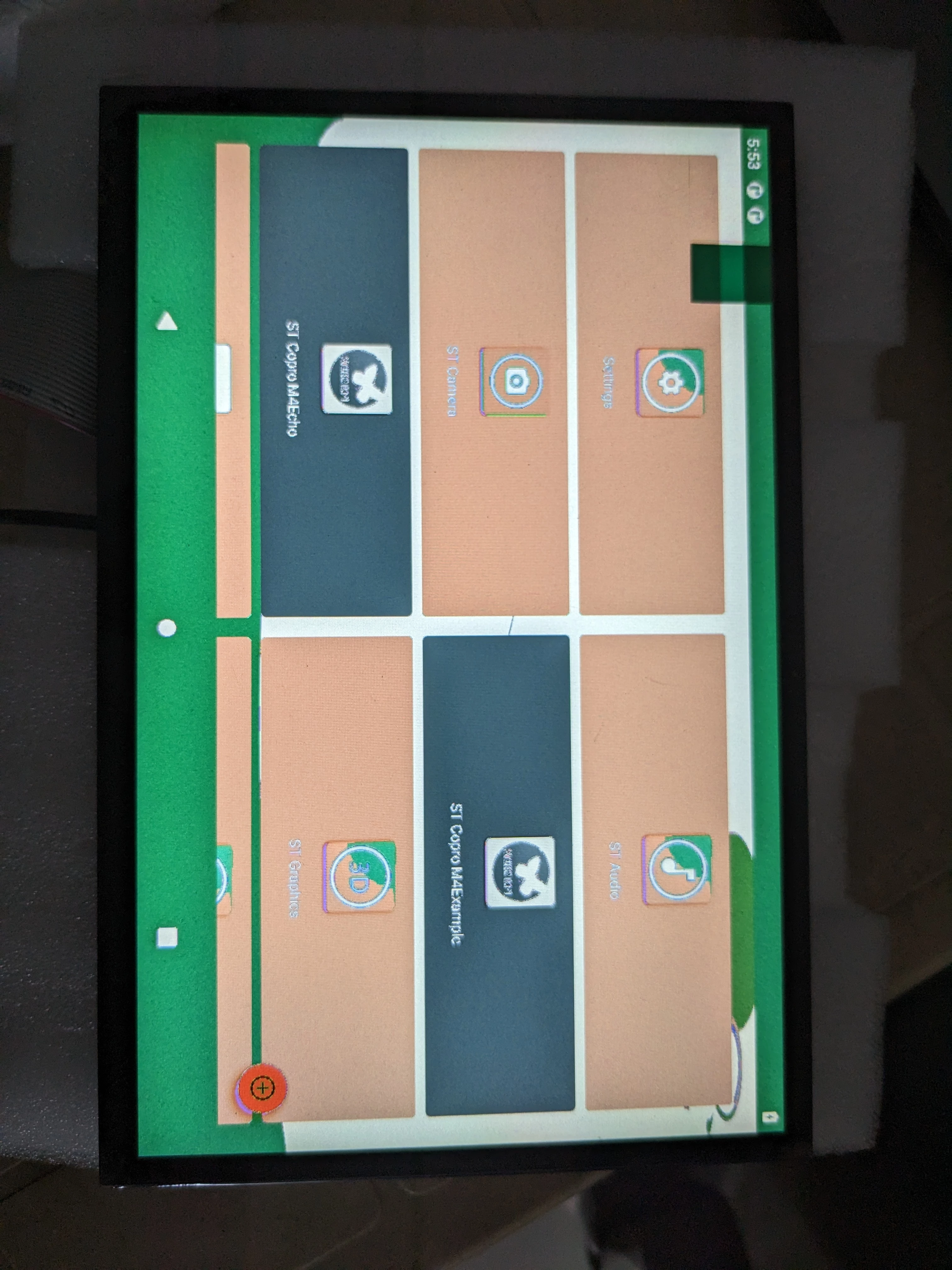

LCD not interpreting colors correctly using LTDC connected to STM32MP157F based custom board.
  • May 16, 2023
  • 0 replies
  • 1448 views
We have a custom board based on STM32MP157 MPU and running AOSP, with AUO G101EVN010 LCD-TFT panel using an LVDS to LTDC converter for interface.
Setup of the system is done using the STM32MP1 distribution for Android.
I am able to get the panel to display the Android UI, but the issue is the colors on the UI.
Below is an image of the Android home screen:
_legacyfs_online_stmicro_images_0693W00000bkDBHQA2.pngObservation: RGB appears to be BRG.

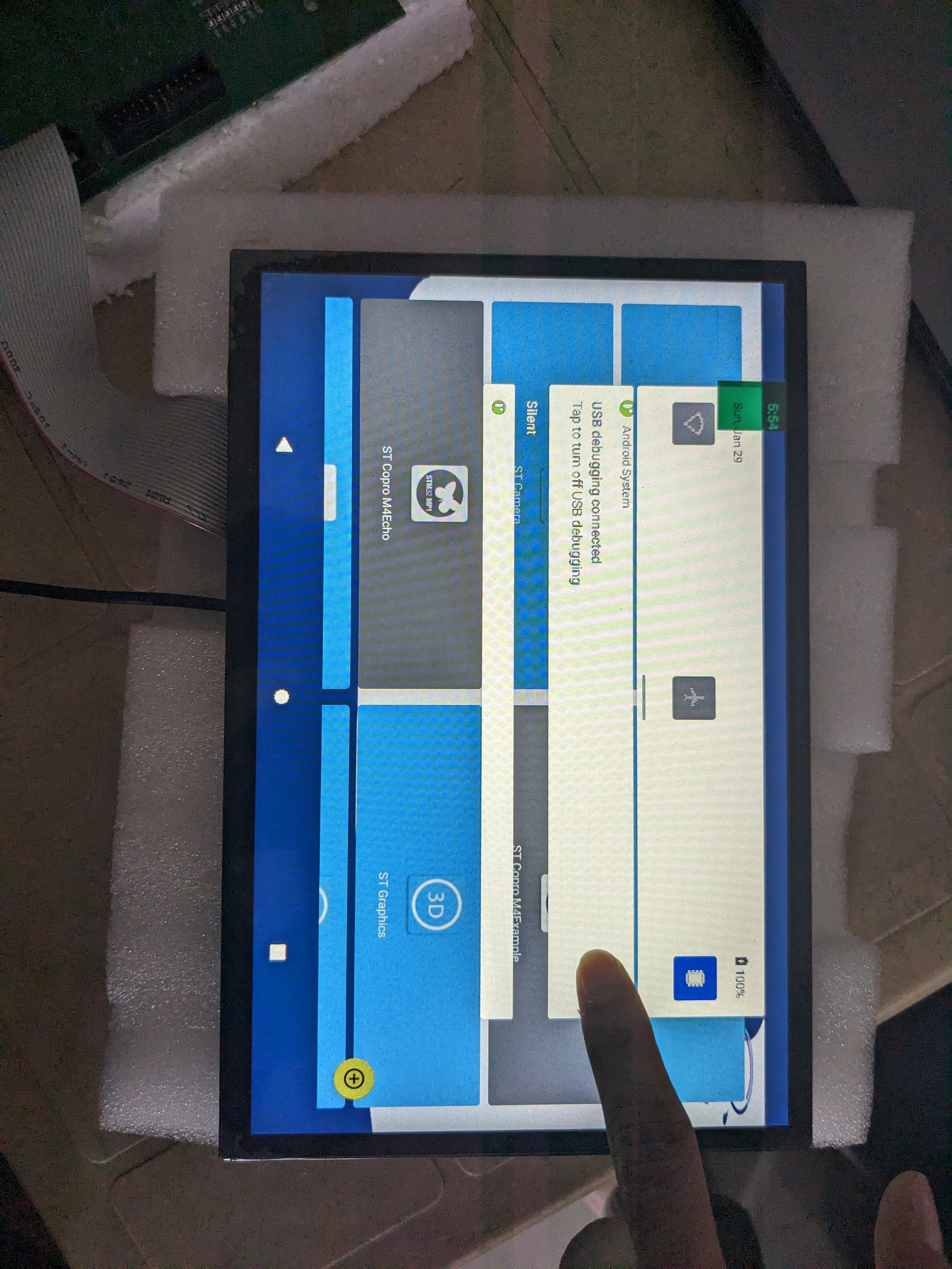

When I pull down the notification panel from the top, the notification overlay shows and it is observed that colors in the background appear correct as seen below:
Not getting where the issue is.
Using the MEDIA_BUS_FMT_RGB666_1X18 format for DRM and LTDC DT node settings as follows:
