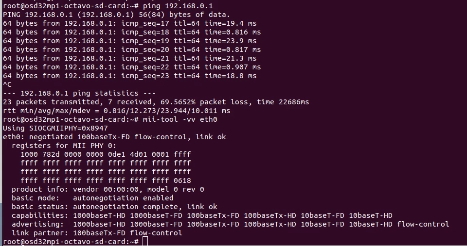

MWoło.2
MWoło.2Author
Senior III
Nov 16, 2021 6:51 PM UTC
I also installed net-tools
and typing
mii-tool -vv eth0
I receive something
0693W00000GXnQDQA1.pngSo I'm not able to read PHY ID.
From the documentation, I read that ID is 0007.C0D1. This ID is identical to LAN911x.
