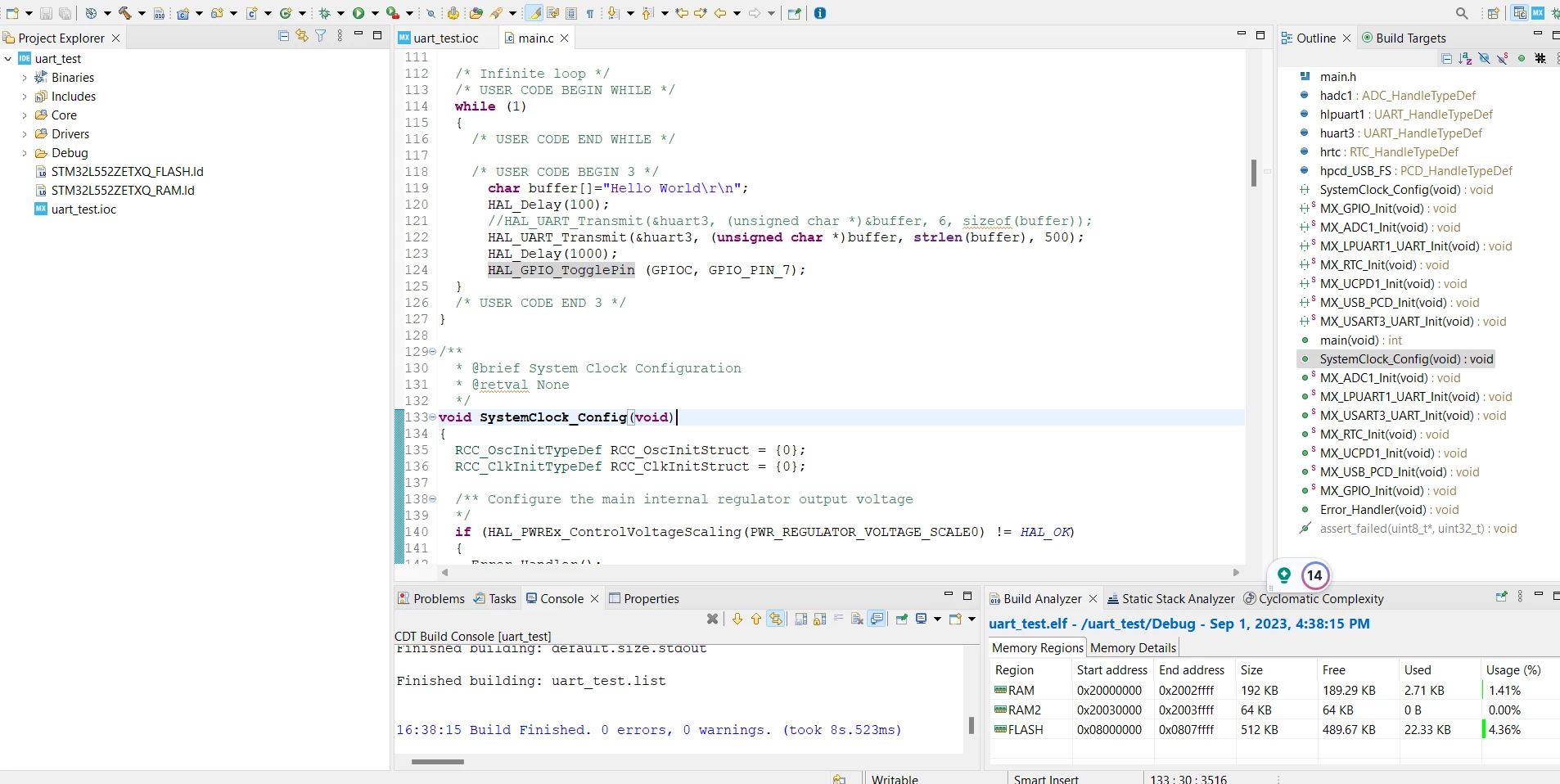

Issue with terminal output at putty with simple Helloworld program using Nucleo-L522ZE-Q.

 while (1)
 /* USER CODE END WHILE */
 /* USER CODE BEGIN 3 */
	 char buffer[]="Hello World\r";
	 HAL_Delay(100);
	 HAL_UART_Transmit(&huart2, (unsigned char *)&buffer, 6, sizeof(buffer));
	 HAL_Delay(1000);
	 HAL_GPIO_TogglePin (GPIOC, GPIO_PIN_7);
 /* USER CODE END 3 */

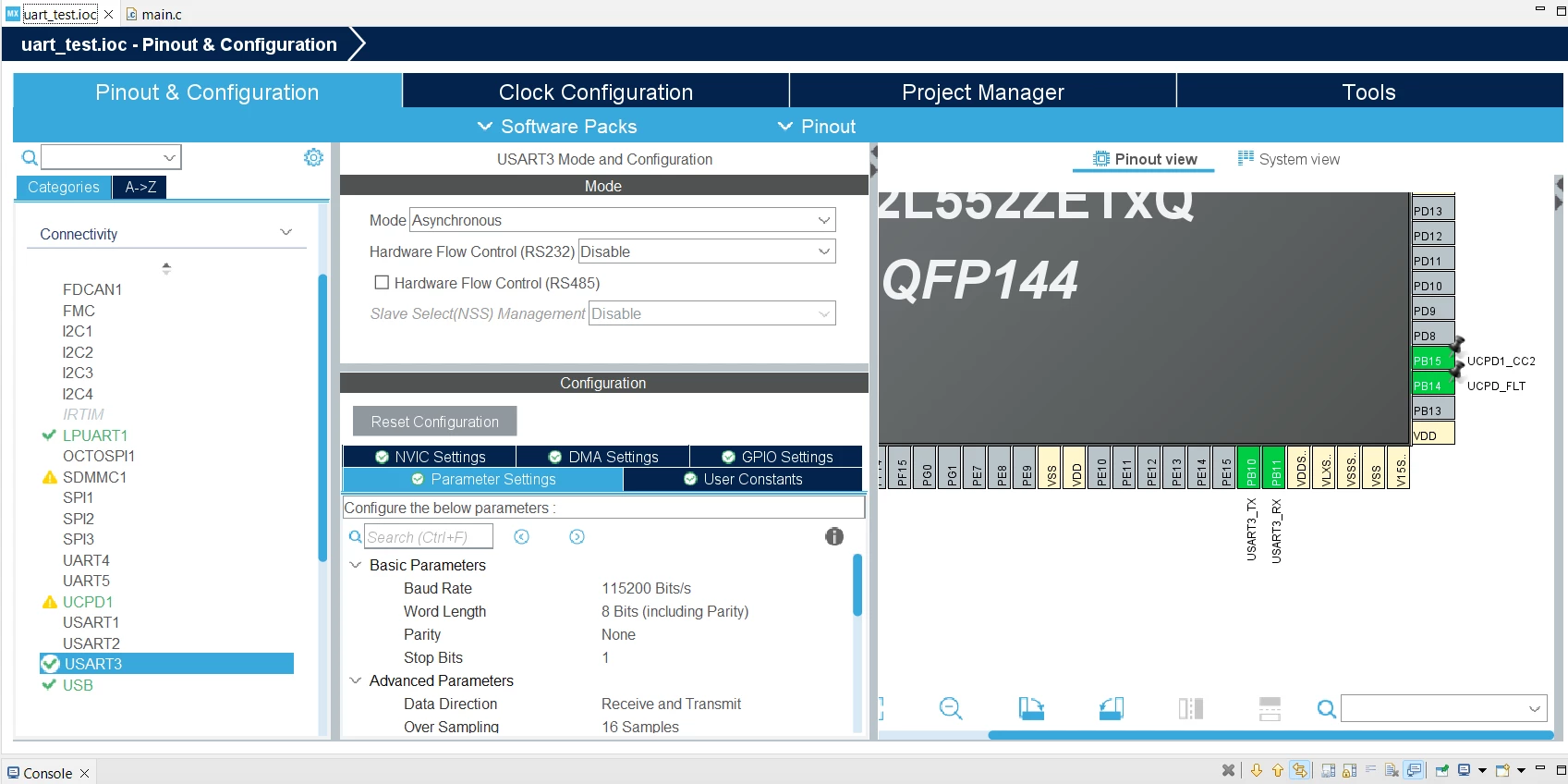

static void MX_USART2_UART_Init(void)
 /* USER CODE BEGIN USART2_Init 0 */
 /* USER CODE END USART2_Init 0 */
 /* USER CODE BEGIN USART2_Init 1 */
 /* USER CODE END USART2_Init 1 */

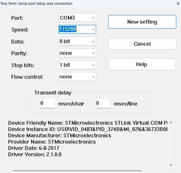

 huart2.Instance = USART2;
 huart2.Init.BaudRate = 115200;
 huart2.Init.WordLength = UART_WORDLENGTH_8B;
 huart2.Init.StopBits = UART_STOPBITS_1;
 huart2.Init.Parity = UART_PARITY_NONE;
 huart2.Init.Mode = UART_MODE_TX_RX;
 huart2.Init.HwFlowCtl = UART_HWCONTROL_NONE;
 huart2.Init.OverSampling = UART_OVERSAMPLING_16;
 huart2.Init.OneBitSampling = UART_ONE_BIT_SAMPLE_DISABLE;
 huart2.Init.ClockPrescaler = UART_PRESCALER_DIV1;
 huart2.AdvancedInit.AdvFeatureInit = UART_ADVFEATURE_NO_INIT;
 if (HAL_UART_Init(&huart2) != HAL_OK)
 Error_Handler();
 if (HAL_UARTEx_SetTxFifoThreshold(&huart2, UART_TXFIFO_THRESHOLD_1_8) != HAL_OK)
 Error_Handler();
 if (HAL_UARTEx_SetRxFifoThreshold(&huart2, UART_RXFIFO_THRESHOLD_1_8) != HAL_OK)
 Error_Handler();
 if (HAL_UARTEx_DisableFifoMode(&huart2) != HAL_OK)
 Error_Handler();

Led is getting toggled but not getting anything at serial output. Please help. Thanks

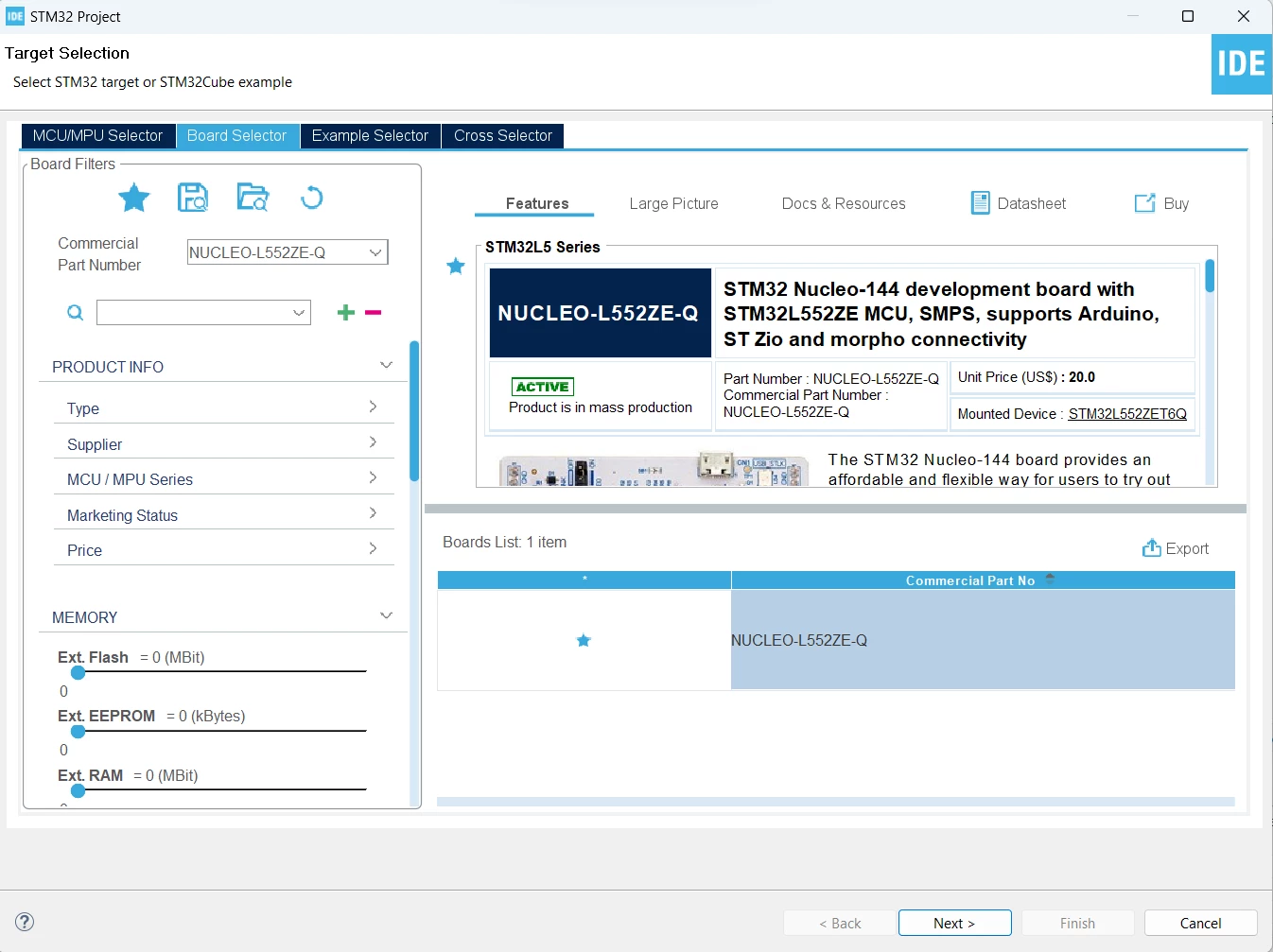

>>I am not sure did i miss something?
The schematic and the user manual? You don't link to the tutorial, so no idea here if it refers to this board, or something else. The ST-LINK VCP has specific wired connectivity to a UART on the STM32L5, LPUART1 is the primary, and you'd have to change a lot of solder bridges to accommodate USART3 on PD8/PD9
To use USART2 you need to wire the pins up to a USB-to-CMOS Serial adapter from SiLabs, FTDI, et al.

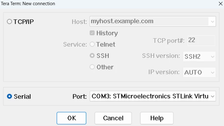

What pins are you using? How are those pins connected to the PC? Can you open the port? What port are you opening? Do your port setting match?
Note that the VCP is on USART3, not USART2.
TeraTerm could also be buffering until it sees a "\n", but less likely.

I have also tried to print hello world using USART3 but could not get at putty teraterm. I have attached the SS of all steps i have done please check. thanks

Sep 1, 2023 00:49 UTC
What pins is it using?
Parameters here are all wrong.
Try this
HAL_UART_Transmit(&huart2, (unsigned char *)buffer, strlen(buffer), 500);
Sep 1, 2023 15:07 UTC

for usart2
PA2 = USART2_TX
PA3 = USART2_RX
for usart3
PB10 = USART3_TX
PB11 = USART3_RX
but it did not work

>>but it did not work
How is USART2 supposed to be working in this context? How's it wired up that would facilitate this?
Isn't the ST-LINK VCP connected via LPUART1 on PG7 and PG8 on the NUCLEO-L552ZE-Q ??
