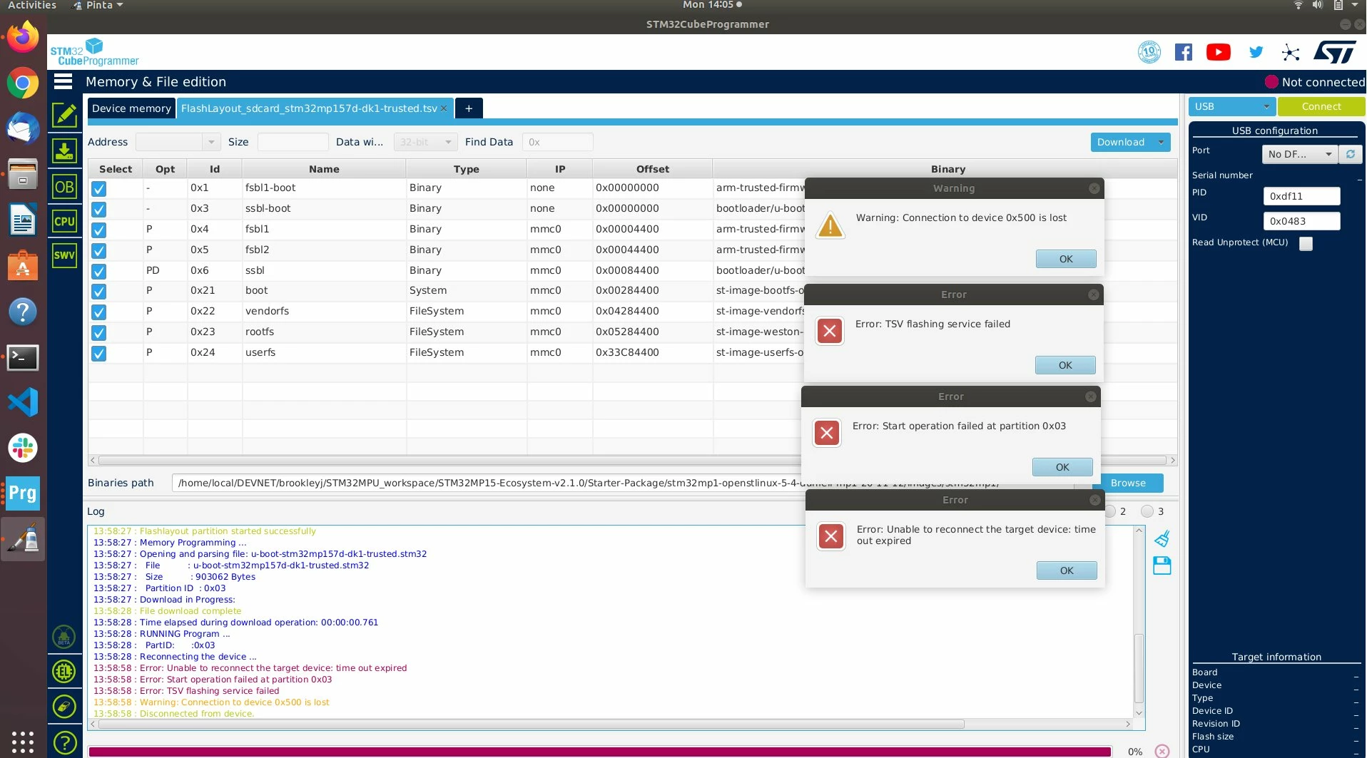

Hello everyone!
I'm getting familiar with the STM32MP1 tools on a linux laptop and I'm trying to burn the demo to my STM32MP1D-DK1 board. I know most the demos are aimed at the DK2 but it's sold out everywhere and I don't currently need wifi or bluetooth (or an LCD), so this seemed good enough for me.
Anyway, I'm trying to follow the instructions on the STM32MP1 wiki page (
https://wiki.st.com/stm32mpu/wiki/Getting_started/STM32MP1_boards/STM32MP157x-DK2/Let%27s_start/Populate_the_target_and_boot_the_image) and I'm running into an issue when trying to burn the firmware:
0693W000008yDwZQAU.jpgUnfortunately, I get the errors above, a red LED (LD5?) starts flashing on and off, a blue LED (LD6?) stays on, and LD4 continues to toggle on and off about every second or so (this was the same prior to burning the firmware as well.

PatrickF
March 30, 2021
please have a look to https://community.st.com/s/article/FAQ-STM32MP1-STM32CubeProgrammer-USB-reconnect-error-at-STM32MP1-boot-device-flashing
As you did not rebuilt the binaries, I think it is a Virtual Machine USB setting issue.
Regards.

PatrickF
April 8, 2021
First, could you try using command line to flash and add "-tm 10000" on the command (increase default timeout to 10 seconds) ?
I agree the FAQ is not crystal clear.
You need to stop load sequence at uBoot console, by enabling only the two first items in CubeProgrammer.
Then, using the serial console (Virtual Com Port of the ST-Link, 115200,n,8,1, see 'The serial terminal'), with CTRL+C you should get the uBoot "STM32MP>" prompt.
Then you could try the requested commands which should make an USB device visible on your PC (this is just for checking purposes).
If not visible, it is a PC setup issue.
Note that the 'DFU in HS Mode' you see is normal and it is the first USB connection from BootROM used to load TF-A and uBoot in RAM.
Then uBoot start and reconnect using a different USB connection 'USB download gadget' (this occur in the log after "Reconnecting the device ..." which is failing on your PC).
Regards.
