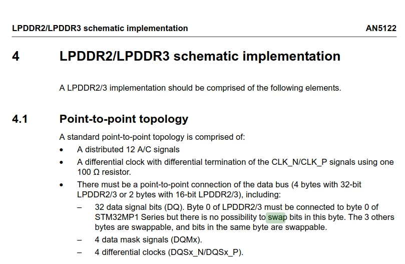

Is there an example of how to perform DDR data bit swapping as described in AN5122?
We are using LPDDR2 and have wired the data bits as per the ST provided example STM32MP15XXAD_LPDDR2x16-Example-A01_Schematic.PDF (attached)
We have swapped the same bits in the DQ15:8 byte as per the PDF but I can't find anything to tell me how to perform this swapping in the devicetree or otherwise.
Below is the screenshot from the Application Note detailing that bit swapping is possible.

Hi @damien1​ ,
on a pure RAM, no matter the data bus swapping (bits within a byte or bytes Vs bytes), your read what your have written. So, no need to configure any HW/SW about this.
Obviously, in case of bytes swap, DQS/DQM should follow their byte.
There is anyway some restriction on byte and but swapping (e.g. D0-D7 on LPDDR2/3 should be on byte0 without any bit swap) as data bus could also carry access to memory internal config/status registers.
On DDR3/DDR3L, all data swaps are allowed because writting memory register is done using address bus as data (which is not the case on LPDDR).
