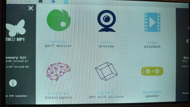

Aug 31, 2021 6:02 PM UTC
Dear MKonz.1,
And so it was, it really helped us a lot!
The mod to the adv7511_drv.c file was key to finally get the kernel to detect ADV7533 and correctly read the display EDID. We also managed to add an IRQ line, even if we found that it doesn't change the behaviour of the driver, even without it, the kernel is able to detect an HDMI connector (plug-in and plug-out events) and EDID. Right now the are trying to find a less demanding screen as at boot we get:
[ 18.513484] Time out check load galcore module expired
[ 29.124419] Time out check galcore device expired
[ 29.178322] Weston already configured on pixman
[ 29.911176] [drm] Warning max phy mbps is used
To also give some details, this is what we get we probe status "cat /sys/kernel/debug/dri/0/state":

Dec 13, 2021 8:53 AM UTC
Dear @MKonz.1​
Sorry for some months of silence, I'm Marco a coworker of Davide in charge since last week of this part of the project.
I made the change you suggested in file KERNEL/drivers/gpu/drm/bridge/synopsys/dw-mipi-dsi.c updating the mode->htotal parameter to mode->hdisplay in dw_mipi_dsi_line_timer_config routine (hdisplay is the name for hactive timing parameter in drm_display_mode structure), but nothing changes on our display (I'm testing with a 1024x600).
I tried to do some changes using /etc/xdg/weston/weston.ini configuration file and I noticed that using B-LCDAD-HDMI adapter:
  • Changes done in [output] section of our HDMI-A-1 are completely ignored, e.g I tried to flip the display using transform=flipped
  • Changes done in [shell] section work, e.g I try to change panel position from bottom to top (panel-position=top)
while both changes done with the display connected to a DK1's native HDMI port work without any troubles.
As Davide wrote in his last post, DK1 handles our display without troubles using LTDC parallel interface routed to a Lattice Sil9022A through a DPI encoder, while our B-LCDAD-HDMI adapter use LTDC parallel interface routed to a ADV7533 through a DSI encoder.
I tried to figure out where the different behaviour could take place and I think it could be on how ADV7533 communicates with the DSI: it seems communication is mislead or broken for some reasons and the system could only use a partial or a default (or hardcoded??) configuration which not completely fit our display. I don't know if there are some linux drivers to add or some other changes to do in the DSI driver.
I hope you have some further suggestions or ideas for us
Best Regards
Marco.

MBassi
Dec 14, 2021 11:19 AM UTC
Thank you @PatrickF​ for the immediate reply,
I tried your solution (both kernel patch and device tree) but unfortunately doesn't solve our issue which seems to be linked to a wrong computation of horizontal back porch or to a misled communication of EDID informations.
I add an image of my display hoping it could help to figure out the issue; if you have any other ideas or suggestions, they could be of help
Best regards
Marco.
