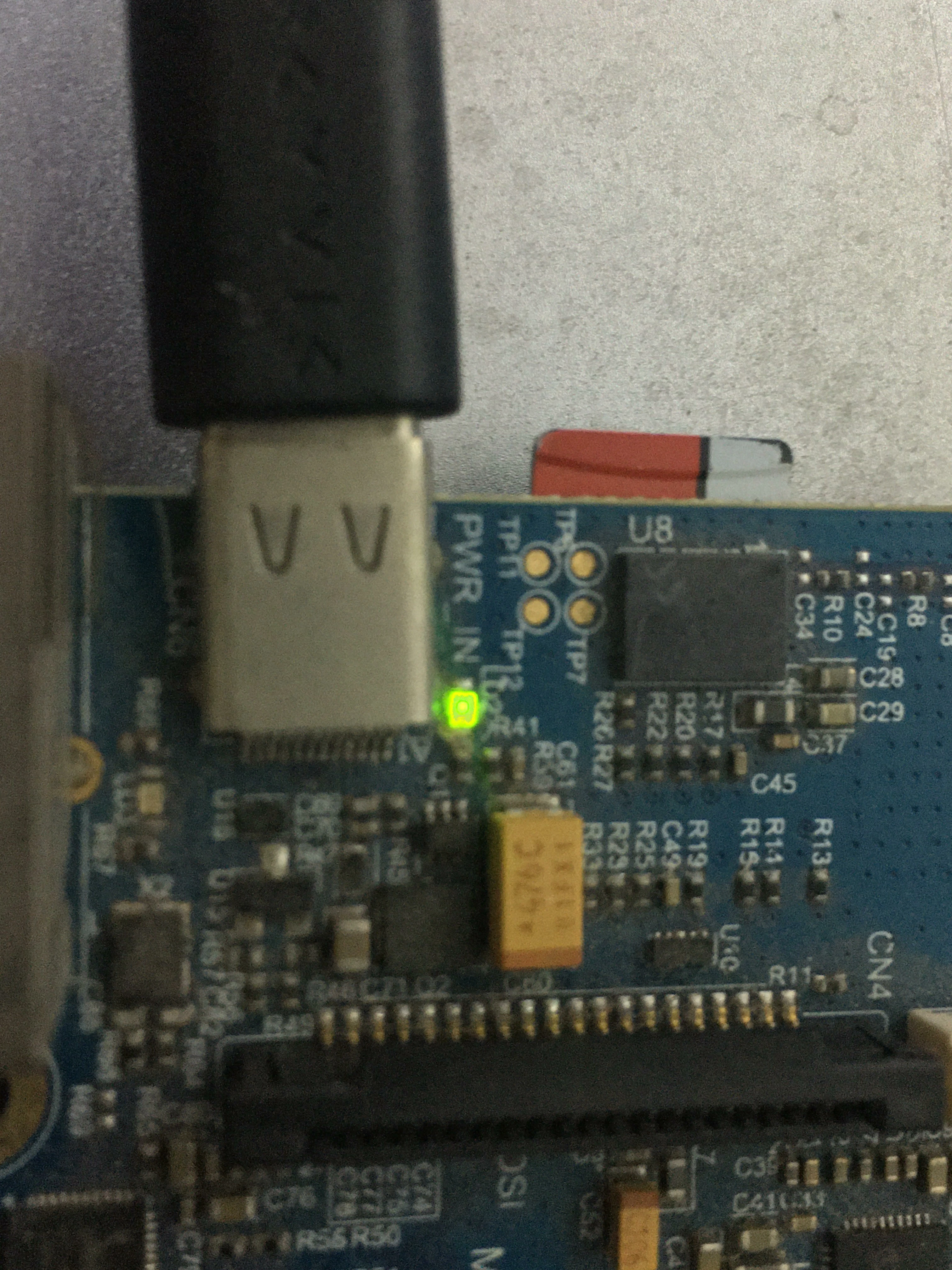

Is my stm32mp157c-dk2 board bricked?
  • September 19, 2021
  • 4 replies
  • 1127 views
I don't know what happened but suddenly on putting the board in boot mode( boot switches ON) , I cant detect the board on the stm32cube programmer and I see a green led ( PWR_IN) continuously blinking!
attached is the image.
Please assist.

PatrickF
September 20, 2021
LD2 is 5V presence, so, if blinking, it is likely the current limitation inside your USB Type-C supply (I assume blinking rate is very slow).
Did you try another USB Type-C supply/cable ?
Regards.

darla14
darla14Author
September 23, 2021
@PatrickF​ Thanks for the reply, Yes I did try another C type USB as well as the USB PD adapter. But same response.
Is there any IC that I have blown up and which could be causing this?
Please advice.
I have access to lab where I have soldering accessories.
Br,
D
Could be any of a number of parts.
Could you have causes an ESD event when you fiddled with the switches?
Placed the board on a conductive surface?
Pull a schematic and start double checking supply rails, etc.
What if you remove the SD card?
