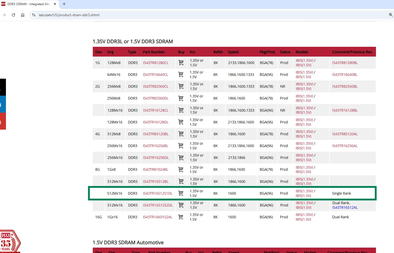

I'm using the mp215 with ddr3l (x16) and an ISSI dram ic that is 8Gb (1 gigabyte) which means it's a dual rank configuration compared to a more typical half gigabyte. As far as im aware all 1GB ddr3 dram ic's are dual rank.

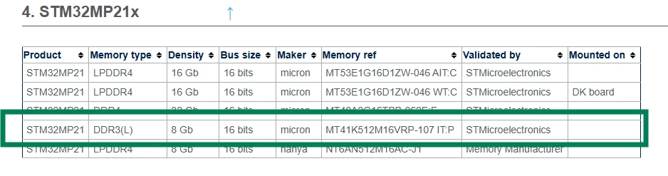

However in the ST Wiki "How to setup the DDR configuration" section 5 the exact opposite is implied. This whole section repeatedly describes a "concrete example" of swapping the swapping the mp215-dk's lpddr4 out with a 1GB ddr3 ic. Also using a theoretical dtsi called "stm32mp21-ddr3-1x8Gbits-1x16bits-800MHz.dtsi" and define "DDR_MEM_SIZE 0x40000000" which is 1GB. So this is conflicting info because i dont see how 1gb ddr3 is possible if it isn't dual rank.
https://wiki.st.com/stm32mpu/wiki/How_to_setup_the_DDR_configuration#STM32MP2_series
However another conflict is in cubemx. I have 16 bit ddr3 set for the DDR_CTRL_PHY config. And i even have Density set to 8Gb implying dual rank. but the greyed out "user input basic" option has NUMRANK_DFI0 set to 1 and it can't be changed. so i don't know how im even supposed to generate a valid dtsi for my case.

There is no conflict with STM32MP2: we only support single-rank with DDR3L, so dual-rank is not possible.
However, it is absolutely possible to find DDR3L 1 GB single-rank devices.
Here is a reference for a DDR3L that is documented on the ST Wiki https://wiki.st.com/stm32mpu/wiki/Validated_DRAM_on_STM32_MPU_portfolio#STM32MP2-
and another one from the same manufacturer you mentioned earlier (ISSI). As you can see in the screenshot, there are indeed two references: one for dual-rank and one for single-rank. You must choose the single-rank version.
