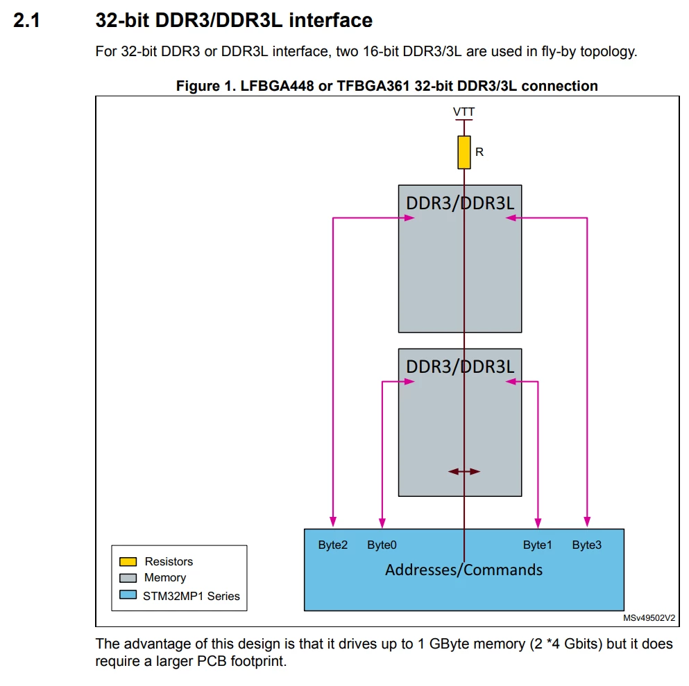

Is byte lane swapping in 16x bit DDR3 RAM possible?
I read the AN5122 which explains in chapter 4.2, that the RAM lane byte 0 must be connected to byte 0 of the MP1 and that the bits swapping is not possible.
However on the EV1 board, the bits inside byte 0 lane are swapped. Furthermore, i do not know how to identify byte 0 at the ram chip, since i want to use two of them.
For the design I am working on, I need 1GB DDR3L RAM, split in two 512MB RAM chips. In the AN I found this picture:
0693W000008xMR9QAM.pngI'd like to place the two chips next to each other, using STM32MP1's Byte 2 / Byte 0 for chip 1 and Byte 1 / Byte 3 for chip 2.
Is this possible to do?
Thanks

AN5122 section 4 is for LPDDR2 or LPDDR3.
For DDR3 and DDR3L, please look at section 3.
I confirm that for DDR3 or DDR3L, as stated in AN5122, byte swap is allowed as well as bit swap within a byte.
Regards.
