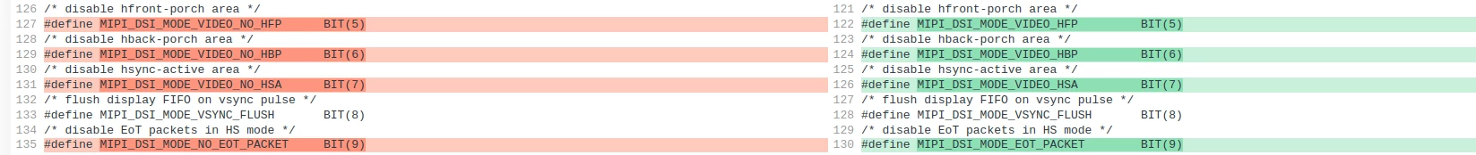

I ported driver from main linux tree : here. to 5.10-stm32mp kernel.
I did encounter these changes in file : dsi_mipi_drm.h and dsi_mipi_drm.c - for function definitions.
I am not sure whether performing these have caused another issue.

There could be many part of the kernel that returns -EINVAL. The simpler way to identify who is returning it, and then why it is returning, is to add some traces with printk() in sn65dsi83_probe().
The change you mention in include/drm/drm_mipi_dsi.h is due to upstream commit 0f3b68b66a6d ("drm/dsi: Add _NO_ to MIPI_DSI_* flags disabling features").
As far as I can see, the patch itself does not impact the code in sn65dsi83 driver nor in the ST DSI driver. I don't expect this to be the reason of the error.
