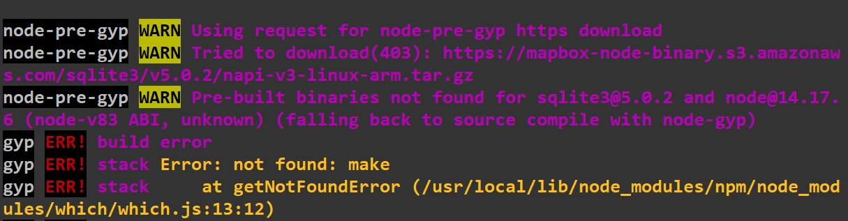

I am working with a STM32MP157F-DK2 board, and I am trying to implement a Node-Red web application. I use the Openstlinux Developer package on the board and thanks to the package repository given by ST, I was able to install the NodeJS LTS version and npm. Node-Red works well, I can see all my flows in the web browser. In my application, I would like to use the node-red-node-sqlite node to access a database hosted in the STM32MP157F-DK2.
Here is my problem: During the installation process, node-pre-gyp is trying to reach an URL where are stored pre-built binaries. However, this URL returns a "Forbidden access" (see image attached), and so node-pre-gyp calls the compiler of the board to build the necessary files. Thus, I cannot install the SQLite node because it requires a compiler during the installation process, compiler that does not exist on the STM32 board.
According to the internet, this error from node-pre-gyp seems to be quite common and I did not find a solution that works, except to build files on source.
So, I would like to know if it is possible to install this node. Has anyone ever had to deal with this node-pre-gyp error on an embedded Linux board?
And if the solution is to build necessary files on source, how is it possible to accomplish that through cross-compilation with the Developer package?
Thank you in advance for your help!

Olivier GALLIEN
Sep 22, 2021 07:02 UTC
Hi @LewisN​ ,
I cannot comment for the access issue to the url. Maybe this require some specific rights ? to pay some fee ?
"because it requires a compiler during the installation process, compiler that does not exist on the STM32 board."
For this point you can make an attempt to generate a image which embed on board compilation capability.
For that you need to generate a new image with Yocto adding :
IMAGE_INSTALL_append = " packagegroup-core-buildessential"
Hope it help
Olivier

LewisN
LewisNAuthor
Oct 1, 2021 14:58 UTC
Hi @Community member​ and @Jean-Marc B​,
I apologize for the late reply, I don't know why but my mailbox identified ST Community as spam, so I only saw your answers yesterday.
Thank you very much for your help, I installed the package from the OpenSTLinux package repository and it works fine.
There is just one more thing to do to make the package work with node-red: It is necessary to modify the first line of the sqlite3-binding.js file which is located in "your_path/node-red-node-sqlite/node_modules/sqlite3/lib/". This file calls the non-existent node-pre-gyp module instead of the @mapbox/node-pre-gyp module.
So, just changing the line "var binary = require('node-pre-gyp');" to "var binary = require('@mapbox/node-pre-gyp');" made everything work.
Thanks again for your support!
Best regards,
Lewis
