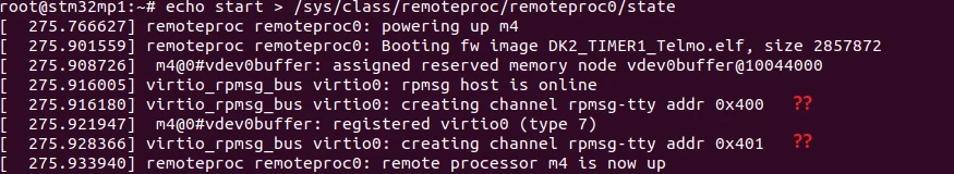

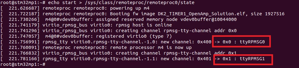

Hello!
I am trying to replicate the workshop STM32MP1 - 11 Inter-Processor Communication Lab Example. I create a new STM32 project and copy all the data from the lab example. Then I connect the device (STM32MP157C-DK2) but the /dev/ttyRPMSG0 does not initialize (so I can´t send message between processors):
  • My program
  • STM32MP1 - 11 Inter-Processor Communication Lab Example
 0693W00000UolVuQAJ.pngI create my program in STM32CubeIDE version 1.10.1.
How can I initilize ttyRPMSG0 and ttyRPMSG1?
Thanks!

Hello @TArre.1​,
Some questions to better understand your issue.
Which version of OpenSTLinux do you use ? 4.0 ?
In your example, does it mean that you cannot see ttyRPMSGX in "/dev/" folder from Linux side ?
Kind regards,
Erwan.
(PS: note that coprocessor communication mechanism has a little bit changed with OSTL4.0, so if you use it, be sure to have the right M4 firmware package in front of your A7 Linux baseline)

Exactly. I initialize in main.c program (in STM32CubeIDE) the vitual uarts:
  huart0.rvdev = &rvdev;
  print_string("Virtual UART0 OpenAMP-rpmsg channel creation\r\n");
  if (VIRT_UART_Init(&huart0) != VIRT_UART_OK) {
   print_string("VIRT_UART_Init UART0 failed.\r\n");
   while(1){}
  huart1.rvdev = &rvdev;
  print_string("Virtual UART1 OpenAMP-rpmsg channel creation\r\n");
  if (VIRT_UART_Init(&huart1) != VIRT_UART_OK) {
   print_string("VIRT_UART_Init UART1 failed.\r\n");
  while(1){}
Then, I run .elf file on the STM32MP157C-DK2 board but in "/dev/" folder I cannot see ttyRPMSGX.
How can I do it?
Thanks!
Erwan SZYMANSKI
October 26, 2022
@TArre.1​ ,
On a personal example of co-processor communication, I have exactly the same logs as yours so it seems that the initialization logs are normal.
Can you share me your main.c file (from M4 side) ? I would like to check if something is going wrong somewhere.
Do you also know the Cube Firmware package version that you are using ?
Kind regards,
Erwan.
Erwan SZYMANSKI
October 26, 2022
A simple test that you can do is to open your virt_uart.c file (Middlewares/Third_Party/OpenAMP/virtual_driver), and check that you have the following line at lines 48-49:
/* this string will be sent to remote processor */
#define RPMSG_SERVICE_NAME "rpmsg-tty"
If you do not see it, for sure you do not have the right version of this file, and it causes the same trouble as you can see right now.
Kind regards,
Erwan.
