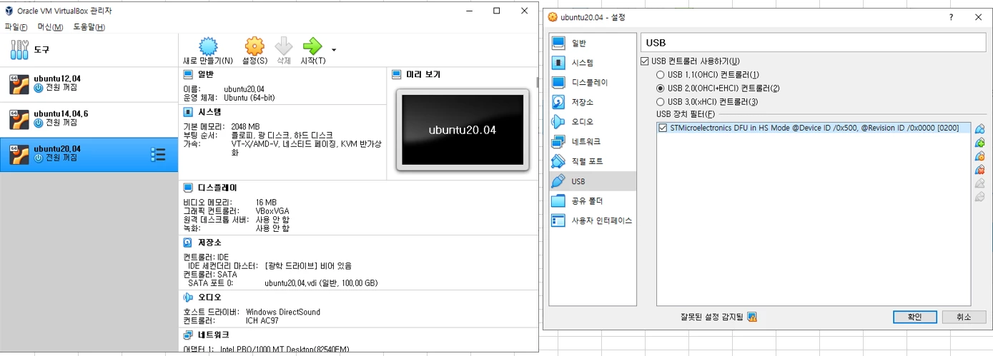

for reference, to use usb in Vmware linux, I am using as follows.0693W00000D04DHQAZ.png​

  1. Regarding the download speed, what do you mean by very slow? I would select USB 3.0 (instead of USB 2.0) as you shared in the above picture. Apart from this there's nothing much you can do to improve the download speed. Did you try the same using STM32CubeProgrammer on Linux side using VMWare?

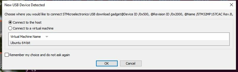

  2. I see Oracle Virtual box in the above picture, which is rather different than VMWare. On VMWare Workstation 16 player, once you plug a USB device, a popup window ask whether to allocate the ressource to VMWare or to the Host, there's also a tick box at the bottom to memorize the ressource allocation.

I confused VMWare and VirtualBox.
I will try what you said.
