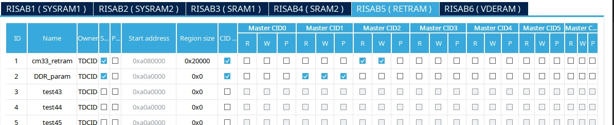

I am trying to load an .elf file on the M33 core on my stm32mp257f processor. When I launch the remote core using remoteproc I get the following errors.
root@stm32mp257f-hydra-mx:~# echo -n /home/root > /sys/module/firmware_class/parameters/path
root@stm32mp257f-hydra-mx:~# echo Sparta.elf > /sys/class/remoteproc/remoteproc0/firmware
root@stm32mp257f-hydra-mx:~# echo start > /sys/class/remoteproc/remoteproc0/state
[ 119.336297] remoteproc remoteproc0: powering up m33
[ 119.511444] remoteproc remoteproc0: Booting fw image Sparta.elf, size 6237772
[ 119.513130] remoteproc remoteproc0: unsupported fw ver: 0
[ 119.518401] remoteproc remoteproc0: no resource table found for this firmware
E/TC:0 stm32_iac_itr:192 IAC exceptions [159:128]: 0x200
E/TC:0 stm32_iac_itr:197 IAC exception ID: 137
E/TC:0 stm32_risaf_dump_erroneous_data:256
DUMPING DATA FOR risaf@420d0000
E/TC:0 stm32_risaf_dump_erroneous_data:257 =====================================================
E/TC:0 stm32_risaf_dump_erroneous_data:258 Status register (IAESR0): 0x91
E/TC:0 stm32_risaf_dump_erroneous_data:266 -----------------------------------------------------
E/TC:0 stm32_risaf_dump_erroneous_data:268 Faulty address (IADDR0): 0x80000000
E/TC:0 stm32_risaf_dump_erroneous_data:287 =====================================================
E/TC:1 stm32_iac_itr:192 IAC exceptions [159:128]: 0x200
[ 119.587786] remoteproc remoteproc0: unsupported fw ver: 0
[ 119.592833] remoteproc remoteproc0: remote processor m33 is now up
root@stm32mp257f-hydra-mx:~# E/TC:1 stm32_iac_itr:197 IAC exception ID: 137
E/TC:1 stm32_iac_itr:197 IAC exception ID: 132
E/TC:1 stm32_risaf_dump_erroneous_data:256
E/TC:1 stm32_risaf_dump_erroneous_data:257 =====================================================
E/TC:1 stm32_risaf_dump_erroneous_data:258 Status register (IAESR0): 0x91
E/TC:1 stm32_risaf_dump_erroneous_data:266 -----------------------------------------------------
E/TC:1 stm32_risaf_dump_erroneous_data:268 Faulty address (IADDR0): 0x80000080
E/TC:1 stm32_risaf_dump_erroneous_data:287 =====================================================
E/TC:1 stm32_risab_dump_erroneous_data:146
DUMPING DATA FOR risab@42130000
E/TC:1 stm32_risab_dump_erroneous_data:147 =====================================================
E/TC:1 stm32_risab_dump_erroneous_data:148 Status register (IAESR): 0x12
E/TC:1 stm32_risab_dump_erroneous_data:150 -----------------------------------------------------
E/TC:1 stm32_risab_dump_erroneous_data:151 Faulty address (IADDR): 0xa080004
E/TC:1 stm32_risab_dump_erroneous_data:154 =====================================================
 Any suggestions?

Jan 24, 2025 4:27 PM UTC
Thanks for your response,
I was thinking that there is an RIF issue, I have just not been able to figure out what is wrong.
I believe the issue is due to something over here at address 0xa080000?
From what I understand the error below means CID2 is making an illegal access to address 0xa080004. But from the configuration above I do not see why that is happening.

could you add dynamic trace in the linux kernel befor staring the Cortex-M33 firmware?
echo -n 'file stm32_rproc.c +p' > /sys/kernel/debug/dynamic_debug/control
Loading and staring the Cortex-M33, you have similar extra debug traces:
[ 44.224640] remoteproc remoteproc0: phdr: type 1 da 0x80100000 memsz 0x540 filesz 0x540
[ 44.224651] remoteproc remoteproc0: phdr: type 1 da 0x80100600 memsz 0x8 filesz 0x8
[ 44.224660] remoteproc remoteproc0: phdr: type 1 da 0x80a00000 memsz 0x18488 filesz 0x18488
[ 44.224737] remoteproc remoteproc0: phdr: type 1 da 0x80e00000 memsz 0x12070 filesz 0x1f8
[ 44.224762] remoteproc remoteproc0: phdr: type 1 da 0x81200000 memsz 0x8c filesz 0x8c
[ 44.224775] remoteproc remoteproc0: boot vector address = 0x80100000
This provides addresses and sizes of Cortex-M33 firmware segments that contain code and data.
Then you have to give RIF access rights to both CID1 (for the load) and CID2 (for the execution) on these memory regions.
A simpler alternative is to suppress CID filtering on these memory regions. Since you are not using OP-TEE with firmware signature and authentication, protecting the memory region is not really necessary.
