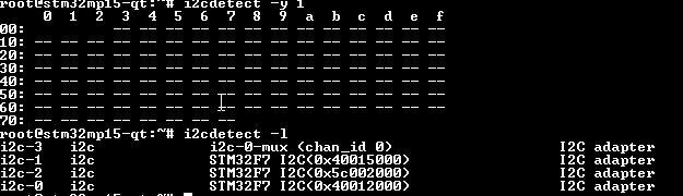

WLeun.3
WLeun.3Author
Jun 1, 2022 10:07 UTC
Hi @PatrickF​ ,
I have a follow up question.
Now my device tree become
&i2c5{
	pinctrl-names = "default", "sleep";
	pinctrl-0 = <&i2c5_pins_mx>;
	pinctrl-1 = <&i2c5_sleep_pins_mx>;
	status = "okay";
	/* USER CODE BEGIN i2c5 */
	tps65023@48 {
		compatible = "ti,tps65023";
		reg = <0x48>;
		status = "okay";
		regulators {
			VDCDC1 {
				regulator-name = "vdd_mpu";
				regulator-always-on;
				regulator-min-microvolt = <1200000>;
				regulator-max-microvolt = <1200000>;
			VDCDC2 {
				regulator-name = "vdd_core";
				regulator-min-microvolt = <3300000>;
				regulator-max-microvolt = <3300000>;
			VDCDC3 {
				regulator-name = "vdd_io";
				regulator-min-microvolt = <1800000>;
				regulator-max-microvolt = <1800000>;
			LDO1 {
				regulator-name = "vdd_usb18";
			LDO2 {
				regulator-name = "vdd_usb33";
	/* USER CODE END i2c5 */
I copy most of the stuff from https://www.kernel.org/doc/Documentation/devicetree/bindings/regulator/tps65023.txt
With this device tree and set REGULATOR_TPS65023=Y
I expect to see something like UU in the 0x48 field of i2cdetect
However, I see nothing
Any clues what am I missing?
Regards,
Leung
PatrickF
Jun 2, 2022 06:29 UTC
Hi @WLeun.3​ ,
not DT expert, but maybe look at :
https://wiki.st.com/stm32mpu/wiki/I2C_device_tree_configuration#DT_configuration_-28board_level-29
Maybe missing some timing information e.g.:
	i2c-scl-rising-time-ns = <185>;
	i2c-scl-falling-time-ns = <20>;
	clock-frequency = <400000>;
Did you configure the right pins (I2C5_SCL on PA11 AF4 and I2C5_SDA and PA12 AF4) ?
cat /sys/kernel/debug/pinctrl/soc:pin-controller@50002000/pinconf-pins | grep I2C5
Is your external device connected on right signals ?
Did you see activity on the I2C lanes when you do i2cdetect ?
I think the 'regulators' are not needed here except if you need a specific supply on your device (which seems not the case here)
Regards.
In order to give better visibility on the answered topics, please click on 'Best Answer' on the reply which solved your issue or answered your question.Tip of the day: Try Sidekick STM32 AI agent
WLeun.3
WLeun.3Author
Jun 6, 2022 09:25 UTC
Hi @PatrickF​ ,
Thanks for your advices.
The I2C lanes do have activity when I do i2cdetect, which suggests the dt are fine, and it is more like a hardware issue.
Finally I found that I have not ground the evaluation kit and my testing board properly, which make the i2c signal floating.
Regards,
Leung
