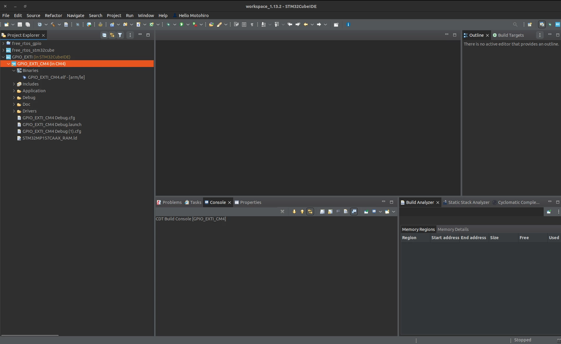

What I have done so far:
1. I have successfully created an elf file using STM32CubeIDE.
2. After building my code using STM32CubeIDE,
      I managed to generate GPIO_EXTI_CM4.elf.
      I got this code from `meta-st-stm32mp/recipes-extended` by `devtool modify m4projects-stm32mp` of bitbake.

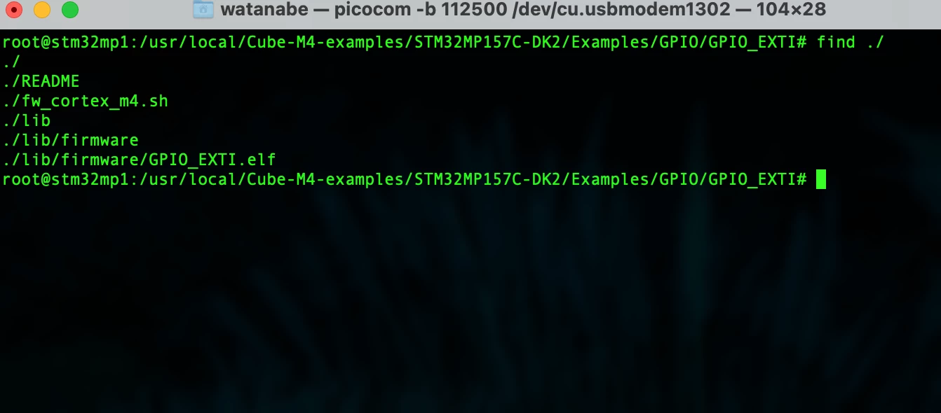

3. I have successfully created an elf file using Yocto,
      I managed to generate PIO_EXTI.elf.
      This is the shell of STM32MP157F-DK2 when built with `meta-st-openstlinux` with `st-image-core` using yocto. I confirmed that the LED works when Button1 is pressed.

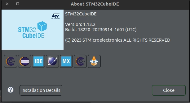

  • Ubuntu 20.04
  • STM32CubeIDE ver 1.131.2
