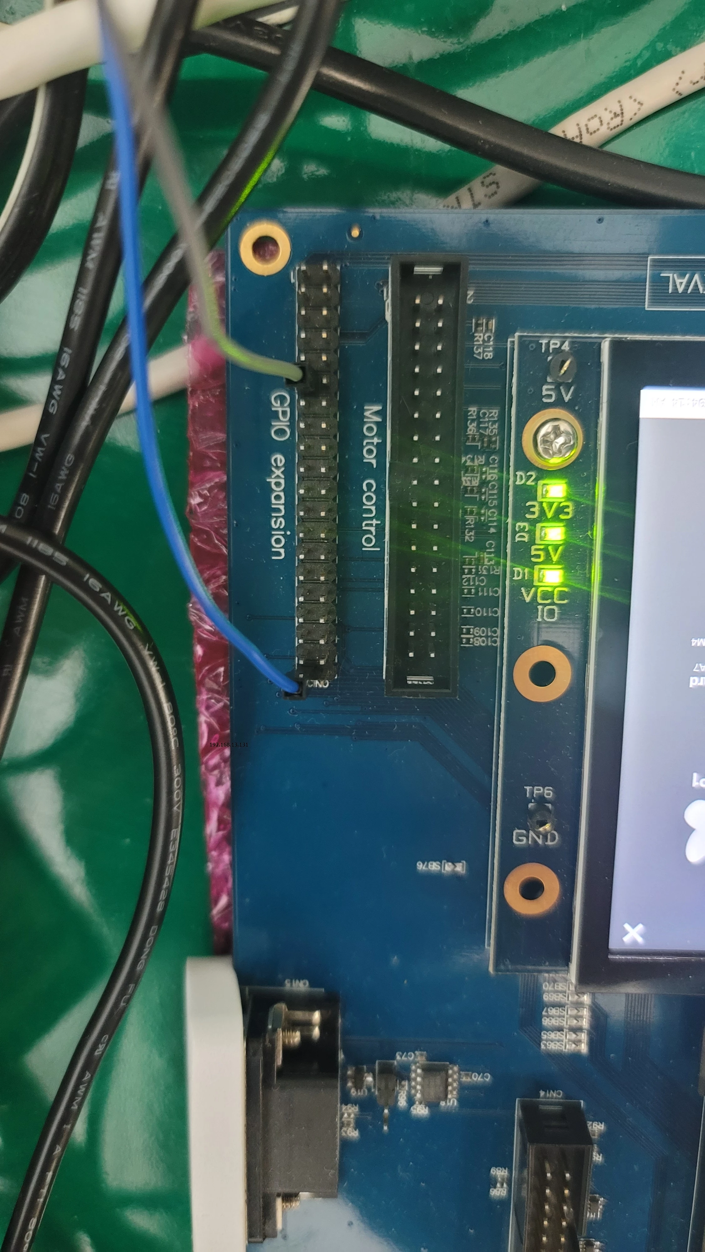

I'd like to output the PPS waveform on the STM32MP157D-EV1 board. But it's not outputting.

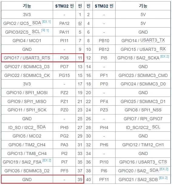

I found the pin of PG8 on the GPIO pin map on the board.

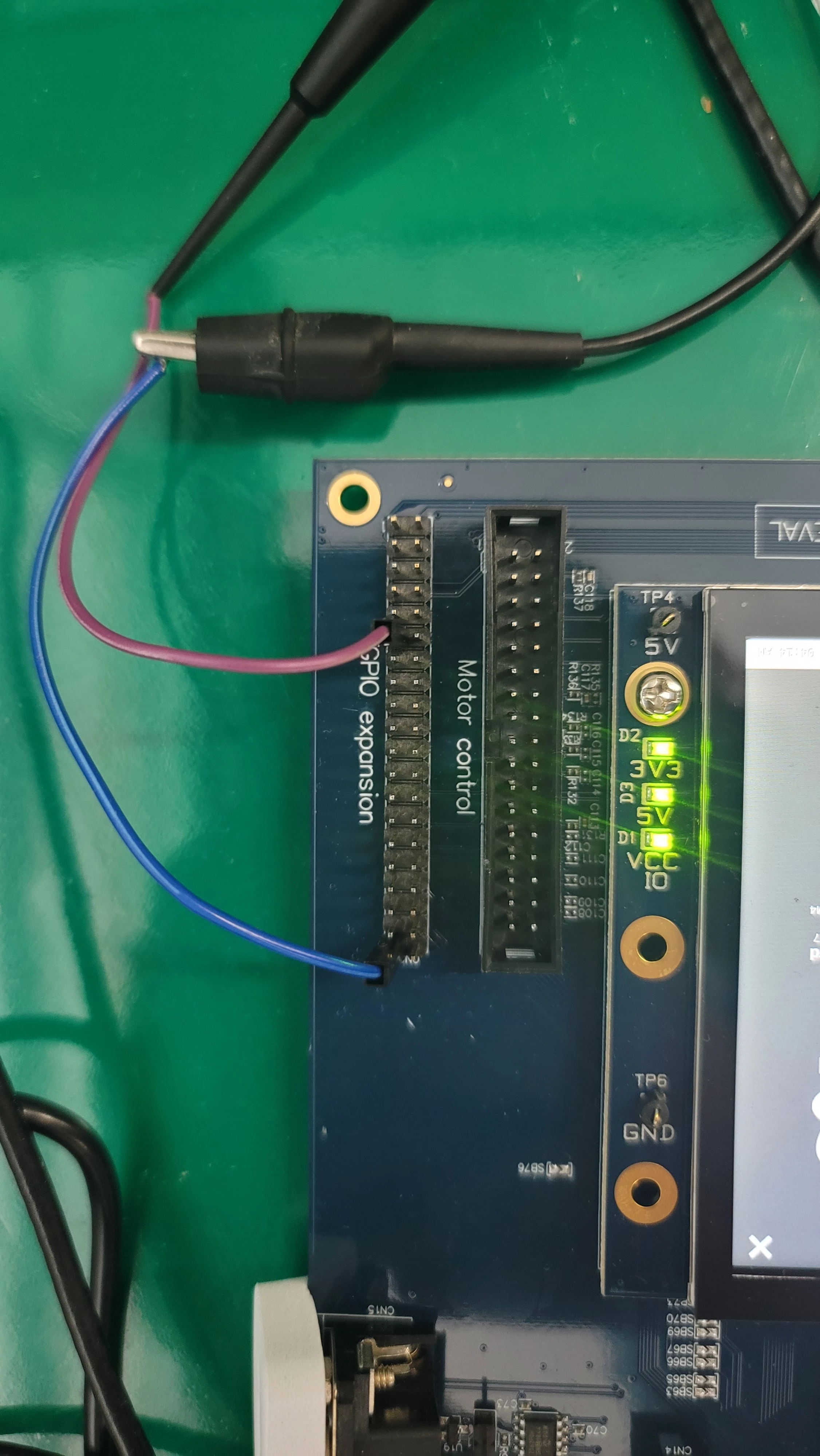

0693W00000aJSdSQAW.pngSo I connected to PG8 and GND to connect with oscilloscope.
0693W00000aJSeGQAW.jpg0693W00000aJSeaQAG.jpgIn the picture, the blue line is the oscilloscope's GND port.
I connected the board and the oscilloscope like the picture above. And I entered the command to output the PPS signal, but the waveform is not displayed.
I looked up various answers and followed the answers such as PTP activation command and adding PG8 to AF11.
What am I doing wrong?

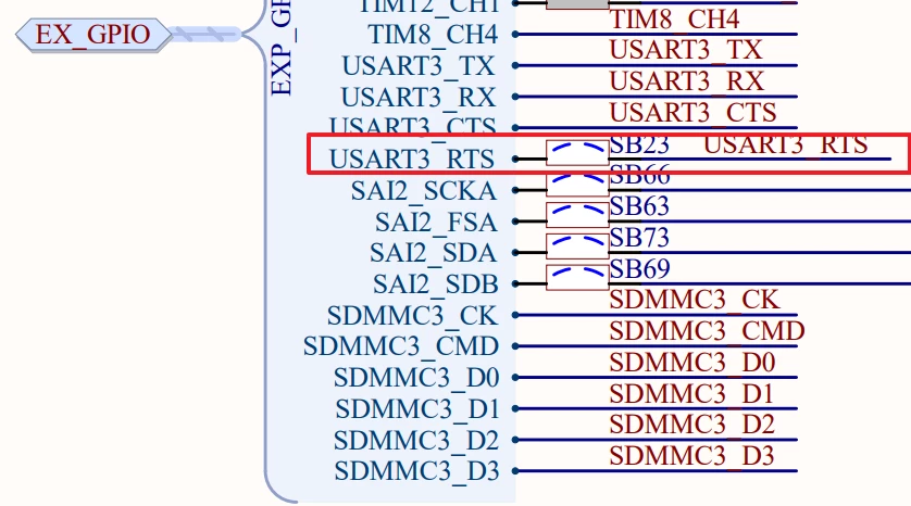

I checked the various documents on the board, and I could find the reason.
I tracked the PPS Out pin PG8 (pin 11) in the circuit diagram document on the board and found that it was disconnected.
I found 'SB23' in the area where the CPU board is located, and after applying the resistor, I confirmed that the PPS signal is output normally.
I don't know why it was released with a cut off.
