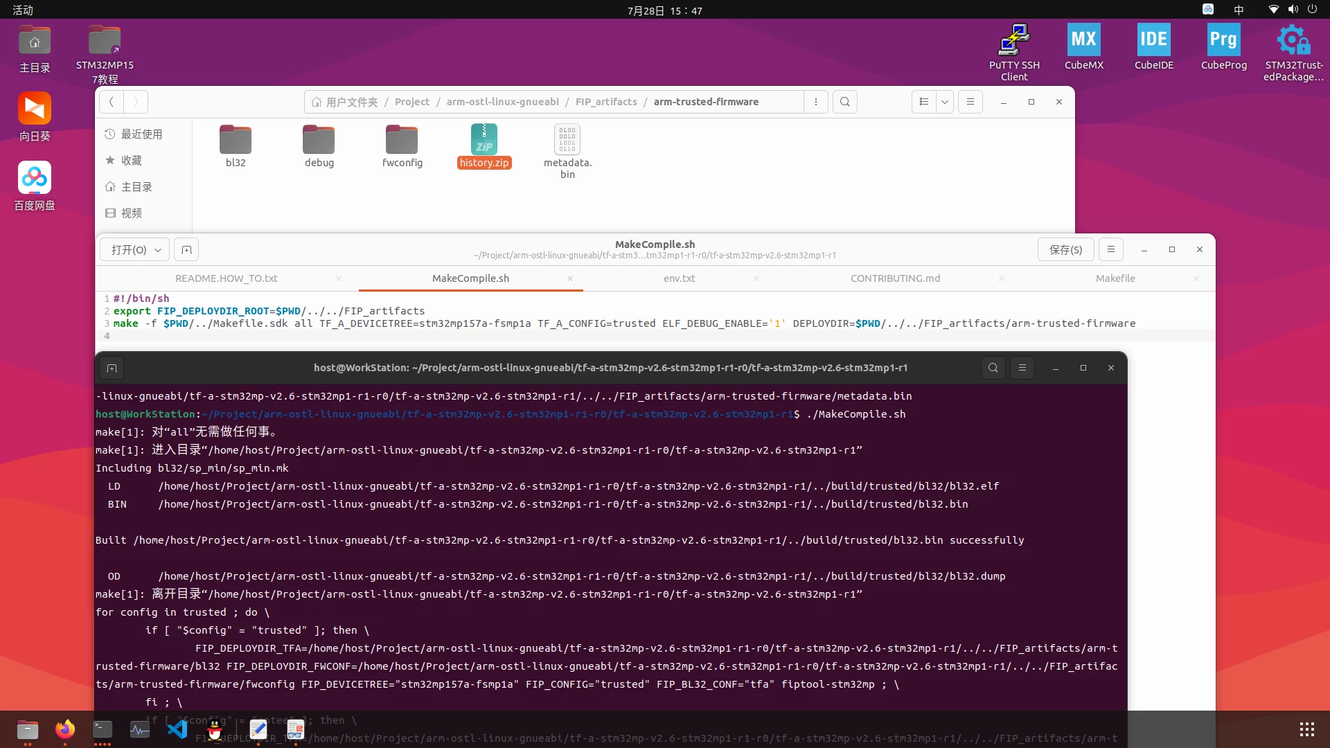

I cannot get "*.stm32" file after compiling tf-a
0693W00000QMMMbQAP.pngI use ubuntu22.04 and stm32mp1-openstlinux-5.15-yocto-kirkstone-mp1-v22.06.15. When compiling TF-A, I can't get STM32 files. Here are the details

Hi xTian.1 (Community Member)
Please follow the README.HOW_TO.txt guidelines in the tf-a developer package directory to make sure all your environment variables are correctly set.
Are you sorted out? It is important also to align the OSTL Developper package to the Yocto SDK.
