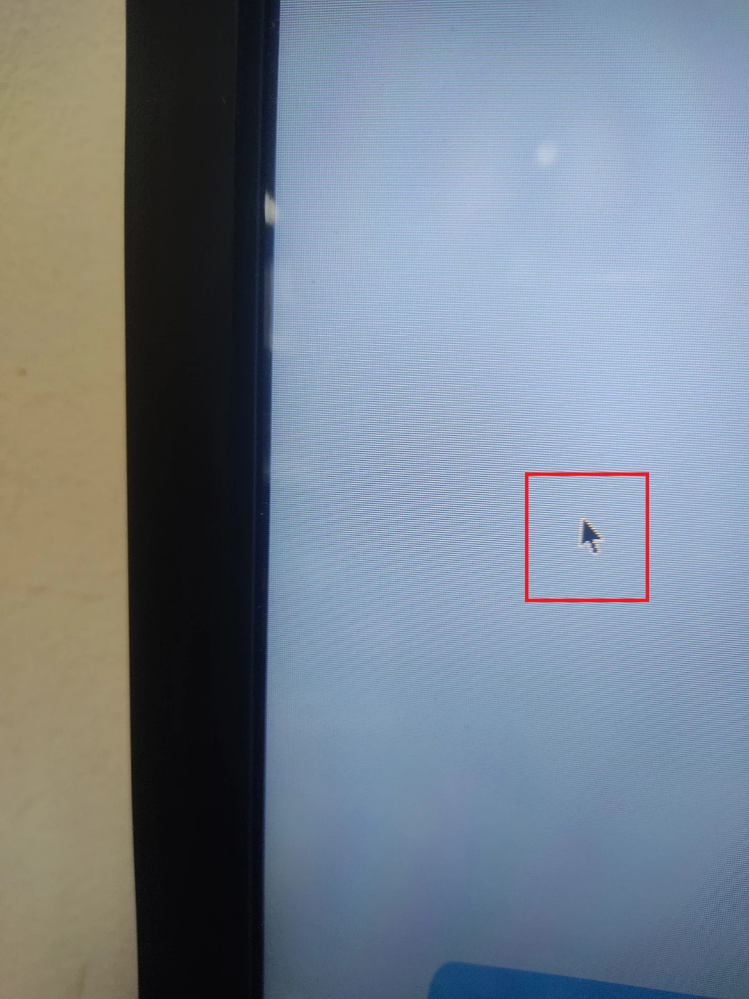

I am working on a project using the STM32MP157F-DK2 board. commercial HDMI touchmonitor and used touch USB for the HDMI and USB terminals on the board. A mouse point cursor is created. I want to delete the mouse cursor. Please let me know how.

Hi @WSung.2​ ,
Weston general information and documentation links are available in this page:
https://wiki.st.com/stm32mpu/wiki/Wayland_Weston_overview
I'm not expert, but googling a bit, I found some information.
Your touch panel is maybe declaring itself as a mouse. Need a touch panel FW update to avoid this.
Seems also possible to define a specific theme with a 'transparent' mouse pointer.
