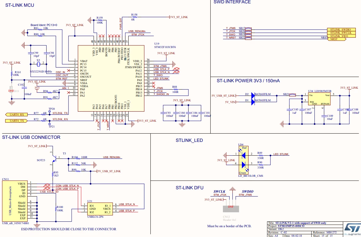

how to use jtag in stm32mp157f-dk2
stm32mp157f-dk2 is not embedded jtag connector,
but i want to use jtag debugger.
st-link(stm32f103cbt6) embedded in stm32mp157f-dk2 has jtag pin(T_JTCK, T_NRST, T_SWO, T_JTMS)
Q1. Can't I use jtag with only ST-LINK USB CONNECTOR (5 pin)?
Q2. what should I do if I want to use jtag?
​0693W00000bhLyaQAE.png​Thank you

Hi @SKim.36​
Could you please elaborate why you need to debug using JTAG ?
Is SWD debug using the embedded STLINK of STM32MP157F-DK2 (CN11 USB) will not workwith your debugger ? We encourage you to use STM32CubeIDE.
Debugging using JTAG or SWD make no differences (SWD is maybe even slightly faster).
JTAG is mandatory for thinks like: Boundary scan chain, multiple devices chaining, specific security RMA flow or for internal logic scan. All are useless on this development board.
If you absolutely need to have a JTAG connector (e.g. to use debugger requiring a specific probe such as Lauterbach Trace32), we recommend to use STM32MP157F-EV1 board which provide natively a JTAG connector.
Alternatively, you could solder wires on STM32MP157F-DK2 using following Test Point. But this need to be mastered to avoid board damages.
0693W00000bhNkzQAE.pngRegards,
