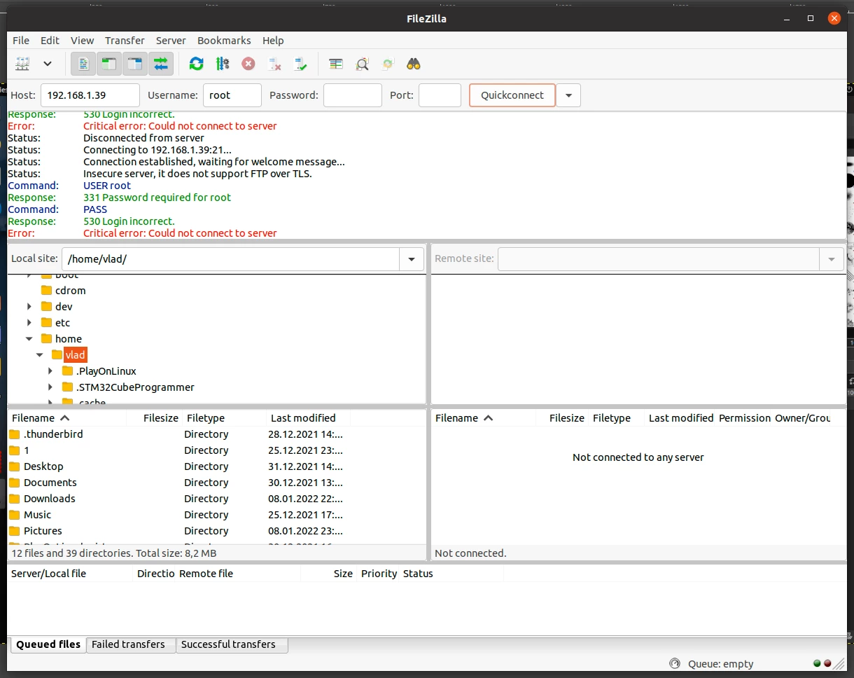

How to setup stm32mp1 board to use with FileZilla?
Hello!
I'm using MYD-YA15XC-T board based on stm32mp151 kernel 5.4.
And wanted to share files with it via FileZilla ftp/sftp file manager on the PC.
But i could not connect to the board, there is always login incorrect error, whichever login or password I try to use:
My board uses automatic login, so there is no password that i know, really.
And i believe the openssh-sftp package is installed.
Do i missing something for sftp/ftp connection to work?
Regards, Vlad.

I have checked and got that the openssh-sftp is installed indeed and apt-cache policy openssh-sftp
command output is just the same as yours.
But trying to connect results in error:
vlad@vlad-MS-7C71:~$ sftp root@192.168.1.39
root@192.168.1.39's password:
sh: /usr/libexec/sftp-server: not found
Connection closed
It seems that sftp-server is missing.
I removed openssh-sftp by apt-get remove openssh-sftp but when trying to reinstall it again by apt-get install openssh-sftp got another error:
root@myir-ya151c-t:~# apt-get install openssh-sftp
Reading package lists... Done
Building dependency tree
Reading state information... Done
Package openssh-sftp is not available, but is referred to by another package.
This may mean that the package is missing, has been obsoleted, or
is only available from another source
E: Package 'openssh-sftp' has no installation candidate
What should I do?
Regards, Vlad.

I did it! I copied sftp-server executable from another image archive, set its permissions and it worked! Both in console and in the FileZilla!
Do not think it could be so easy!
My current working SD card image based on MYiR minimalistic core distributive, which lacks some even basic features, it must be because of this...
Thanks a lot again, it real pleasure see you guys helping people here, even newbies just like me :)
