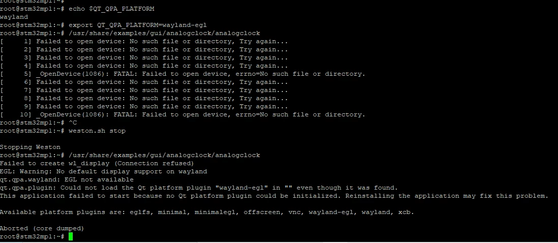

Hi @zqizh.1​
could you try to define the following environment variable please?
export QT_QPA_PLATFORM=wayland-egl
Then re-launch your application.
Best regards,
--JM
zqizh.1
zqizh.1Author
Mar 7, 2022 07:27 UTC
Hi JM,
There is no difference, please see the log.
0693W00000Kbc4oQAB.pngRgds,
QiZhang
Jean-Marc B
Mar 7, 2022 10:32 UTC
Hi @zqizh.1​
I just rebuilt the st-example-image-qtwayland image and ran /usr/share/examples/gui/analogclock/analogclock without any trouble.
By the way, the environment variable QT_QPA_PLATFORM should not be set to wayland-egl but to wayland (it should be set by default when booting the board with the image as we see it from your log).
So there is another problem ;)
Which is your Distribution kit version please? Is it based on ecosystem-3.1 ?
Best regards,
--JM
