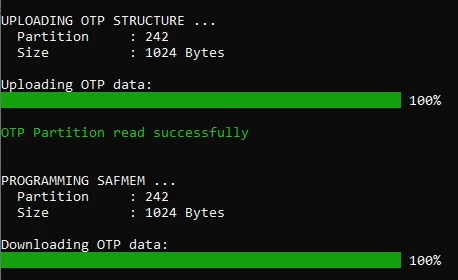

I followed ST wiki, success to display OTP by the command:
STM32_Programmer_CLI.exe --connect port=usb1 -otp displ

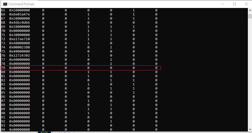

Then I try to test writing a value to wordid 79 which currently is 0x00000000, and free for user.
STM32_Programmer_CLI -c port=usb1 -otp program wordID=0x4F value=0x12345678
No thing wrong, command return sucess:
I display cmd again, it is till 0x00000000, even reset the board.
0693W00000QMIYYQA5.png Any one know what I am missing, please?

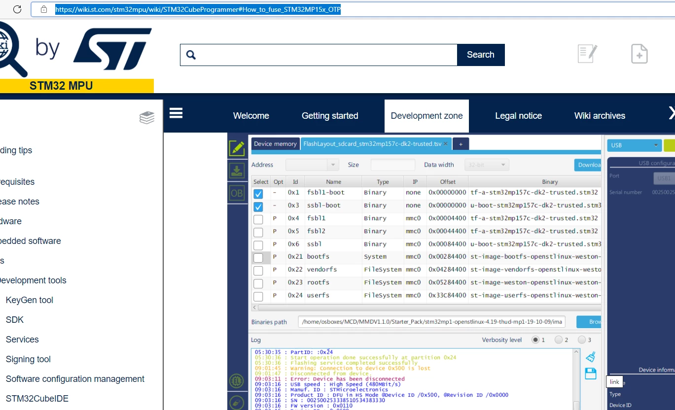

I follow steps from here:
The SDK I downloaded just last week.
The board is STM32MP157F-DK2 - Discovery kit with STM32MP157F MPU - STMicroelectronics

Hi, the screenshot I capture from wiki that why it is MP157C.
I ran on my PC it was MP157F-DK2 already. I just installed everything from last week. Should are they up to date?
Note here is, all messages are returned sucesful, no error as you see on my first post. Just value at id 79th is not updated. I selected 79 because I see all lock value is zero, that make me think is it OK to read or write.

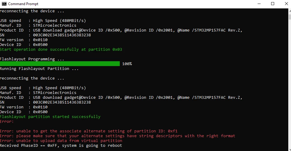

@OlivierK​
I tried the command line as your suggest, instead of GUI application, then I got this error, hopefully you will see something wrong in my side.
