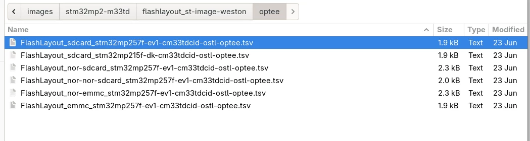

Sep 8, 2025 8:43 AM UTC
Thank you for the quick response !
I downloaded the M33 package and i was wondering where can I find a FlashLayout corresponding to my board (ie: STM32MP257F-DK).
Here is what I currently have with the FLASH-stm32mp2-m33td-openstlinux-6.6-yocto-scarthgap-mpu-v25.06.11 package
