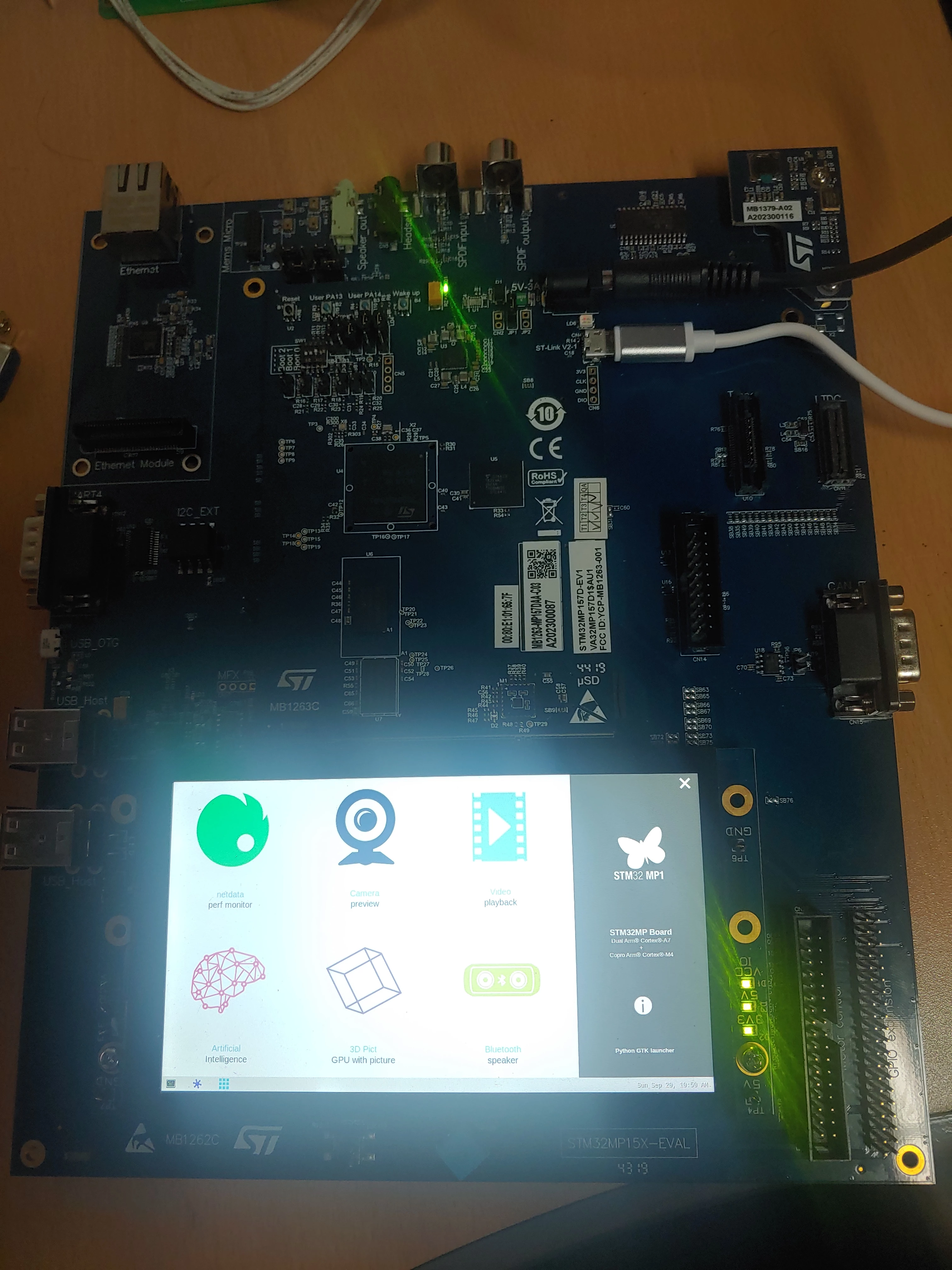

How to get terminal on STM32MP157D-EV1? The COM port cann't be seen from the host PC.
The board is set up as follows, and USB of ST-Link V2-1 is connected to Host PC.
when using Linux host pc , /dev/ATM* devices not recognized.
So I used a Windows PC, but it is not recognized either.
Do I need to install a special driver to recognize the Uart serial?

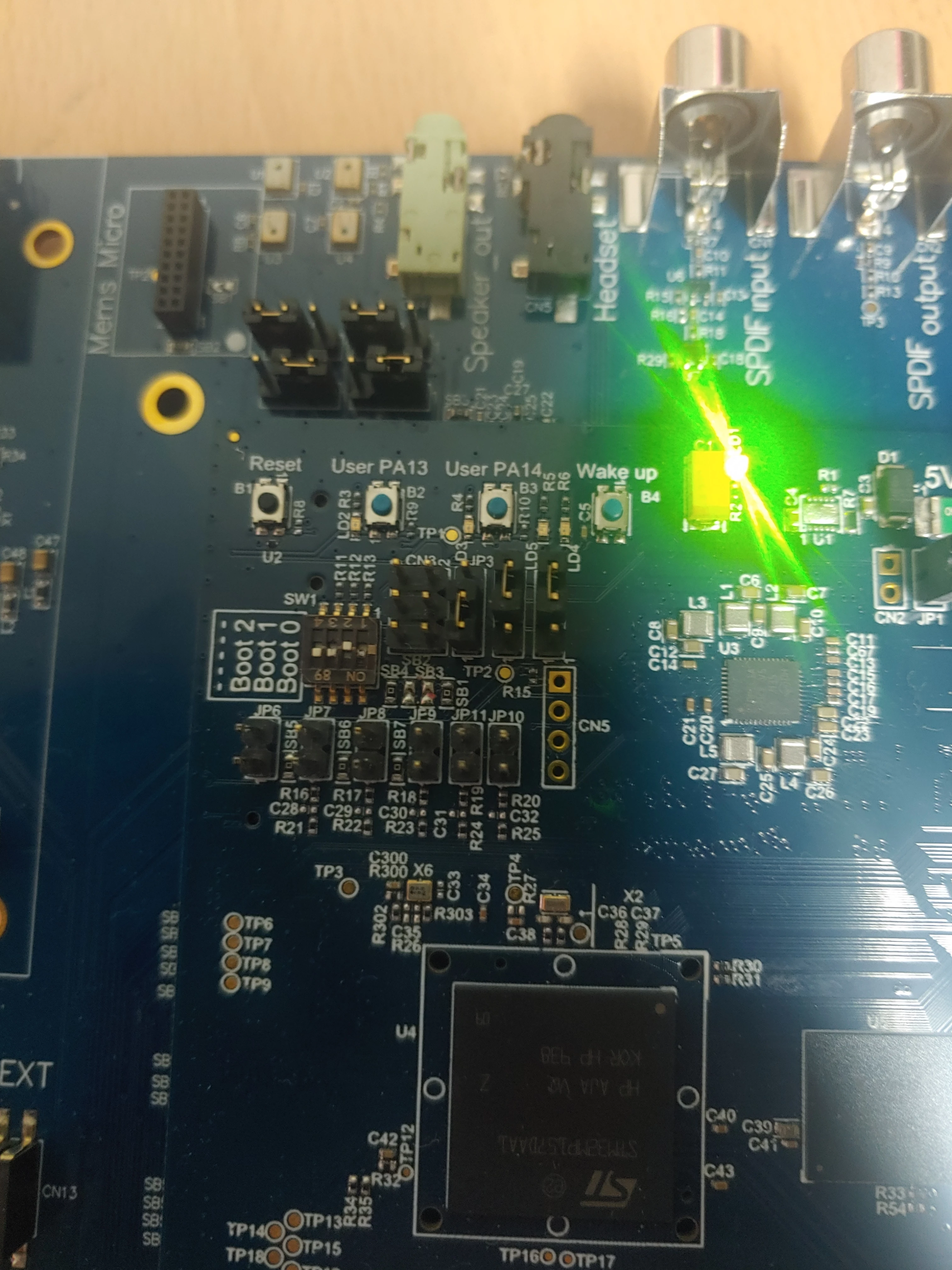

Or is there a problem with the Jumper setting?

Oh ~~~~~~~~~ Sorry,,,
JP1 must be removed.

I set the jumpers same (JP1 removed, JP4[2-3], JP5[2-3]). However, when I connect the USB cable from CN4(ST-Link V2-1) to PC, the results are still same as yours. (Linux host pc: /dev/ttyACM* devices not recognized. Windows PC: the USB is not recognized either.) Do I need any other driver or accessory for this?
Thanks.

what is the status of LD6 ?
Check your USB cable, there is some USB cables (provided with cheap gadgets) which does not have USB data connected (only VBUS wires) !

LD6 is off.
I tried other 3 USB cables. They are all the same.
